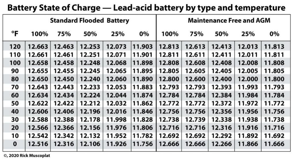

Your radio is a parasitic drain (channel and preference memory) as well as settings for the sun roof and lift gate windows. Make sure you don't have a dome light staying on or maybe a stuck door switch. Check the battery voltage before you start up. Voltage in cold weather should be at least 12.5 volts on a fully charged battery and not lower than 12.2. Outside temperature affects battery voltage on a full charge.
