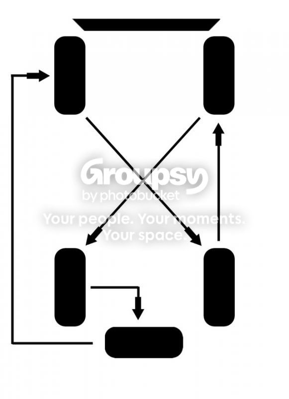

So I have my 4 general at2 for about 10-15k miles. Originally I bought 4. Just recently, few days I got my 5th wheel. And it's currently on my tire carrier. Wondering if it's worth to rotate the 5 fifth wheel in at this point ? How do you properly rotate the 5th wheel on 4x4. Sorry for dumb question

The important thing is to do it the same way every time. This is mine:
5wheelrotation_zps8c99abfa.jpg~original
But I agree you really should start with 5 new tires. Not a good idea to start now.

it is good to include the spare tire in the rotation to get the spare tire worn also so you get an evenly worn set of 5 tires. also, unused tires do not last as long as used tires as they tend to develop cracks.
i always buy a set of five tires and rotate them every 5000 km. i use Fig. G in the link below:

Yes I understand. And I wish I did ordered it first time. So my concern is my 4 tires have 10-15k miles. And the new spar 0 lol. Is it worth it rotating in

The original 4 should have just minimal wear. I don't see a big problem in adding in the 5th tire… I'd be more concerned about changing the direction of rotation because I've been told not to do it.

I am using this method at 5000 mile intervals on my wifes GX470, were at 30,000 miles and no problems.
Having a 5 tire rotation plan helps you not have to buy a whole new set when one of them is destroyed when they are 50% worn. I suggest comparing the tread depth on your unused spare and rotate it in if it's within a couple 32nds of the others.
