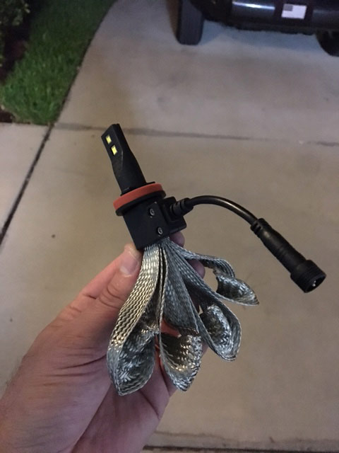

simple question : since the XenonDepot low beam LED headlight bulb has 1 set of diode on each side of the black plastic mast set 180 degree apart could it be possible to manufacture them so that they both face on one side (side that faces the projector lens of course ) so that the output would be almost twice as efficient given the side projector mounting .
I modified a pic of my own bulb as to demonstrate the modification (hope XenonDepot doesn't mind)

Here's the deal. A halogen bulb emits light 360° whereas an led emits at an 180° pattern. An LED bulb would have to have one on each side to emit a full 360° To even compare to a standard halogen bulb.

Even then, you are not getting a full 360 degrees of light emitting from the LED stalk. The other 2 surfaces are void of LED's.

in the case of the 2014/16 4runner the projector is a little weird since the bulb enters the projector at an angle close to 90 degree , I was told that a big percentage of the light emitted by the back LED was not reflected to its full potential.
maybe the black plastic piece that holds the LEDS could be thinner that would help I'm sure.
