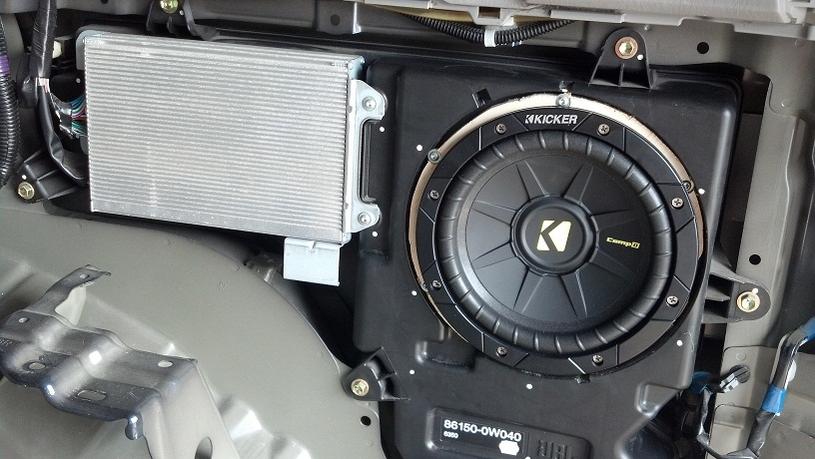

The sub (Kicker 40CWD82) came in yesterday and is now installed. It is about as close to a direct drop in as we can get I guess. It is actually a smaller diameter than the stock sub and a little deeper so I made an adaptor ring out of 3/4" ply wood using a jig saw. Marked the stock holes, drilled them and mounted the adaptor in place. Then took the stock sub power wires and took the clips apart which reveals the standard speaker wire blade connectors inside. Plugged the wires in. Screwed the sub into place and then cranked it up. It sounds really good. I can't compare it to a stock sub because mine was blown when I bought it but it is a very clean sound.
Did you add an extra amp for the sub?
NOPE! stock amp and wiring. This sub is dual voice coil 2ohm same as stock. A different amp would undoubtedly sound better but I was going for straight stock speaker replacement.
