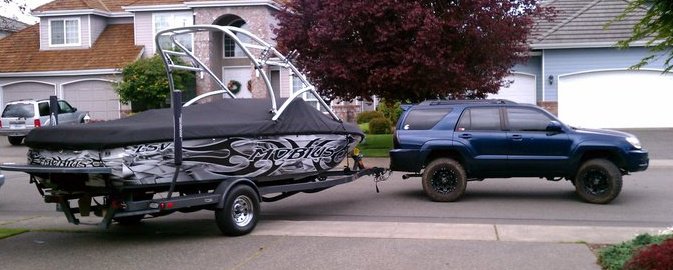

My V6 on steroids had no problems towing our 4500lb wakeboat for hours on end when i would take long trips, even short trips when i had 33's, You will be more then fine, Just keep your tranny and diff treated like a king and it will reward you back
Good luck fishin! I sure do love the occasional bass that will come my way, but you wont be findin any fish in my boat!:fishing:
