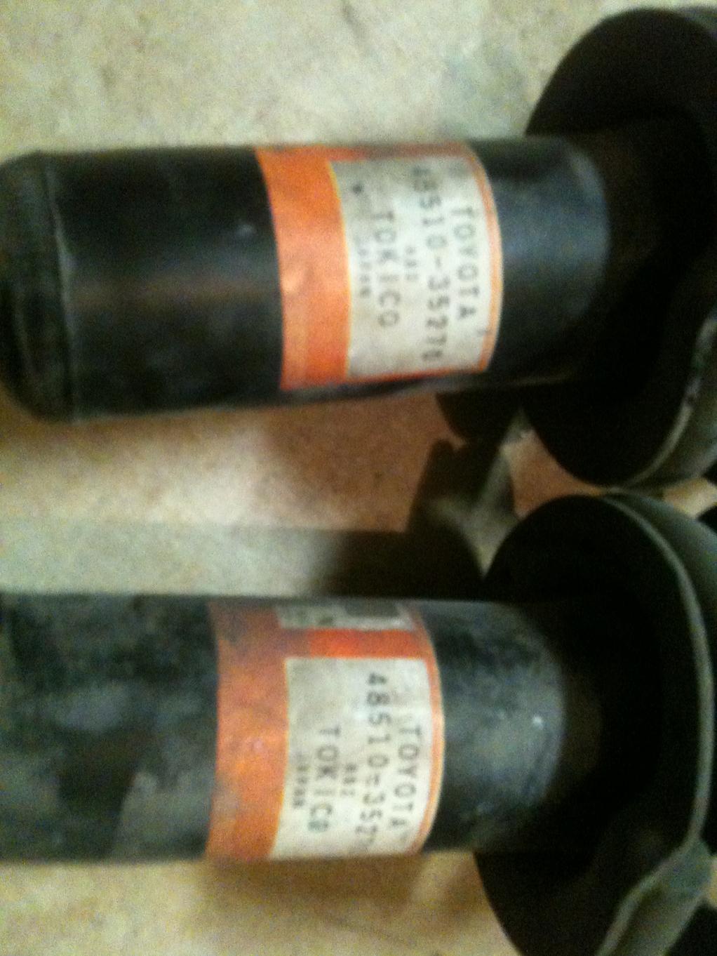

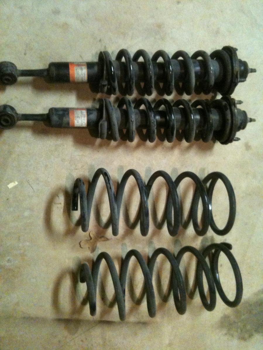

Just met the guy and picked up the coils, he puts the box of goodies in my car for me and I notice the front coils have the shocks still mounted in them. He said "Enjoy!!!" and wouldn't accept any money. He said they had been sitting in his garage forever and he was happy to see them go to me. Chalk another one up for why it is awesome to like cars and have boobs!!! These coils and shocks came off his 07 FJ at 26k miles. Should I go ahead and install the front FJ shocks with these coils? Wouldn't that mess up the shocks in the rear because those would still be a part of the XReas system and the ones in the front wouldn't be....
Haha. When replacing the XREAS, you must replace all at once. The shocks are linked together, right front to left rear and left front to right rear. I'd say do the coils only and keep XREAS for now, especially since you don't have the rear shocks. The two spacers you linked to are the ones people are using, it strictly depends on how much lift you'd like to have.

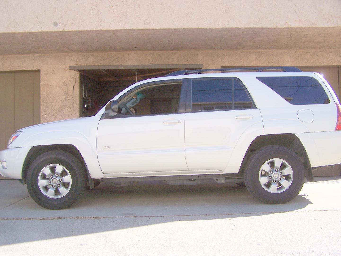

here are a few pics of mine before/after and with measurements on the
V6 2Wd 2004.
I'll say it again and again, get the 1/2" to go on the fj stuff and you'll be happier than prom night.

Since the 5100's are always on back order, if it were me, I would do the fj swap with the toytec 1/2" spacer. it's super easy to install in about 4-6 hours for the entire truck.
take a look at my post #32 and you can see the before and after looks of things + the measurements. it sits perfect and if you notice, lets say you go over a speed bump, the stock with come down pretty harsh. After the swap, is rolls over them perfectly and rides great.

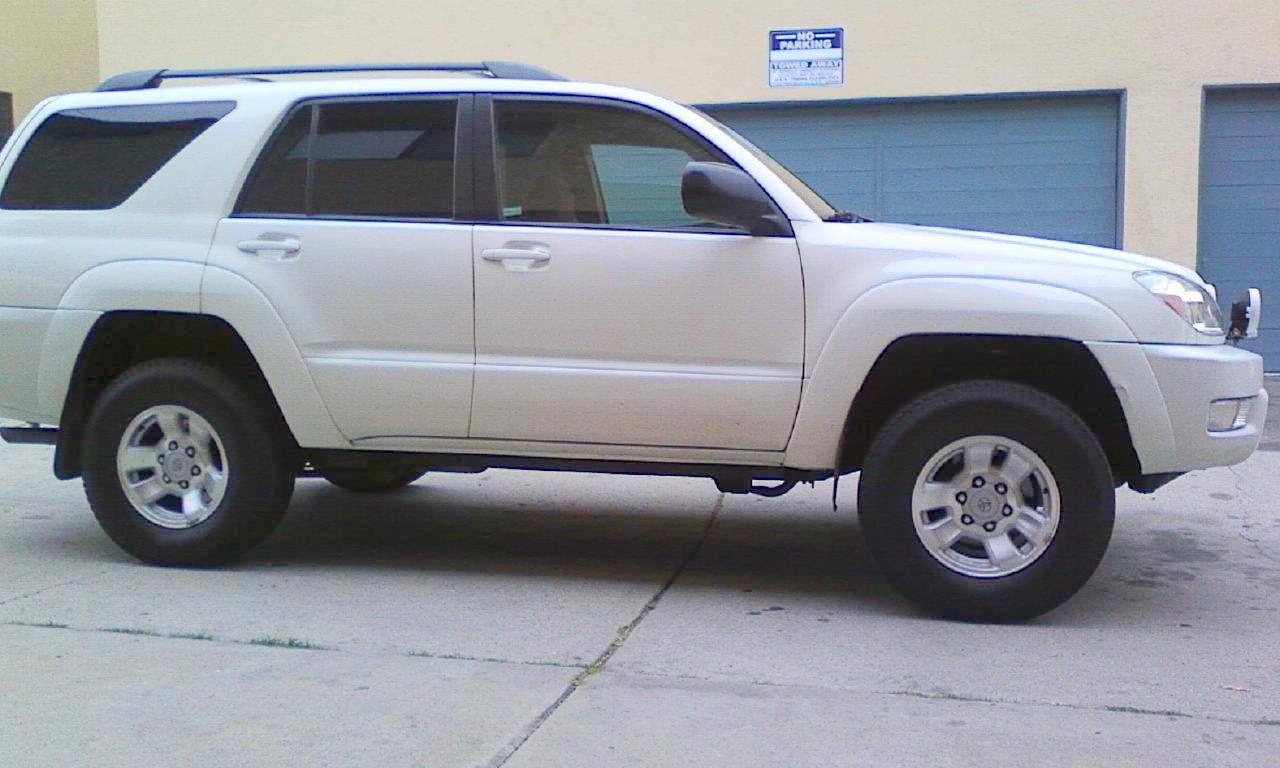

I didn't see any pics of the 1/4" spacer in here, so here is a pic of my v6 2wd when I had 1/4" spacers and FJ coils. I personally think it looks better than 1/2" because the running boards are still level and there is a tiny bit of rake.
