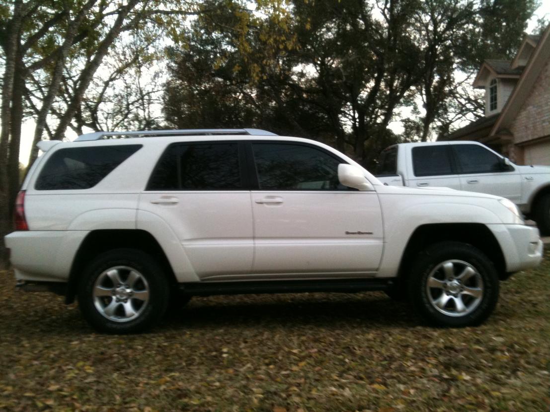

I am having trouble uploading pics but I absolutely love the difference in the ride and height of my 4runner after I took out XREAS and added FJ coils and Bilstein5100s. I ended up gaining a little over 2" in the front and 1.125-1.253" in the rear.
Before: Front Driver 33 7/8" Front Passenger: 33 3/4"
Rear Driver 35 1/4" Rear Passenger: 35 7/8"
After: Front Driver 35 7/8" Front Passenger: 35 7/8"
Rear Driver 36 3/8" Rear Passenger: 37 1/8"
I am .75" off in the rear when the gas tank was 1/4 full. Dont know why that is. I also noticed that my gas milage says I am now getting 23.2MPGs when before the changes it normally said 18-19MPGs, I dont know why that is either.
All in all I havent found a reason to not like the changes that I made. I just wish I could figure out posting pics. I have tried to upload them from photobucket too but it says the files are still too big.

Your ride looks great! Hope you enjoy it. I did mine with 810moto about a month ago and I'm still impressed with how good it looks. Just wanted to drop by to let you know that you could use rust-oleum undercoating rubberized paint on your tire wells to make them look brand new. It makes a big difference! Thanks 810moto for the help and the heads up on the rubberized paint.
Thanks Jibberjabber!!! Sorry about the photobucket links, I couldn't figure out how to upload it like everyone else does on here. (still learning)
Crappy iPhone Shot
