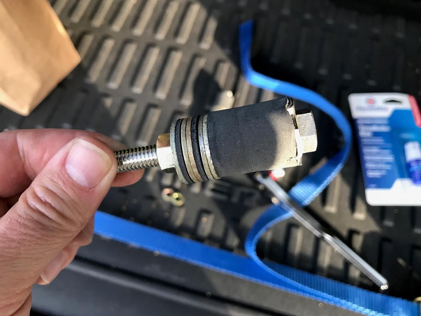

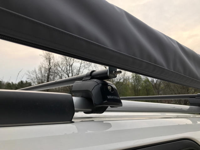

I posted this in another awning thread but I made compression fit mounts for my Yakima bars and mounted the awning up with those. I have done 8k miles with it up there and about 2k at 75-80 on the Interstate. Two 10mm nuts and it is off.
