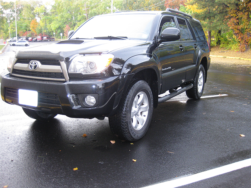

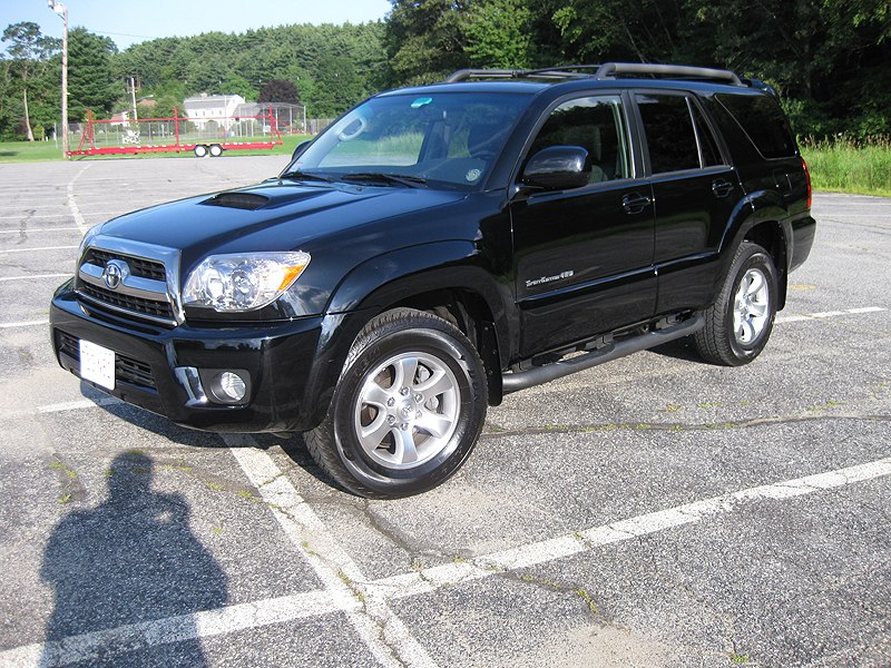

ok it's in.
it wasnt as scary as expected with the xreas lines, but still a little annoying to deal with.
before & after
very slight difference... i was expecting more.
any opinions on if i can get 32s in? i was thinking 'of course' before, but it looks tight still.
