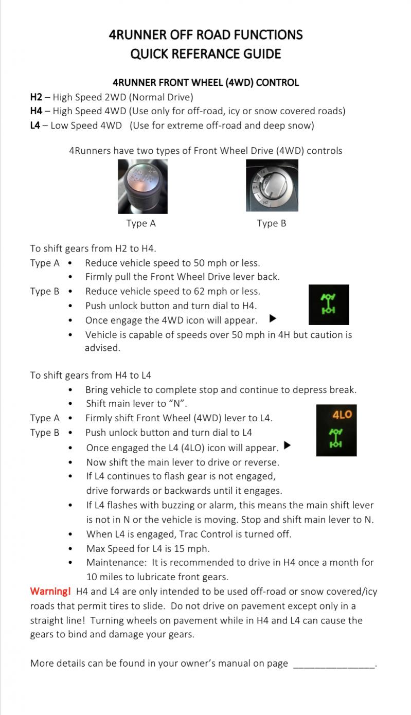

Hi All
I got the cooties for Christmas so I have been spending my off time familiarizing myself with my off-road controls. But if you don’t have a chance to use or practice a skill you tend to forget things over time. Also when I was a new 4Runner owner there were a lot of new off-road functions that I have never seen before. The biggest challenge for me was trying to understand which function was the best one to use under what condition. The owners manual doesn’t do the best job in explaining all of it. So I did a lot of research and watched a lot of video and wrote a brief description of each function and when to use them so I would have a better understanding on how to use them. So I wouldn’t forget, I decided to create off Off-Road Quick Reference Guide to keep in my truck in case I ever need a quick refresher. I figure there are a lot of other 4Runner owners who are new owners or infrequent off-roaders who might find these helpful.
I plan on laminating it and sized it to fit in that useless tissue box holder. It’s not designed to fit all the info from the owners manual, just the most important stuff. At the bottom there is a space to write or use a label maker to put the page where the information can be found in your manual.
Anyway, this is just a draft. I wanted to get some community feedback for improvements before I make the final version. I already see where there are a few spots that need to be fixed. Once I’m done I will update these photos for anyone who wants to use them.

Whats with the constant mention of front wheel drive? lol. Also, no way its a good thing to change the truck to 4H while still moving. Nevermind up to 50MPH!! that sounds like a catastrophe waiting to happen!

I’m not a fan of the term either. That why I added 4WD but I used it because that’s the term in the manual. Maybe I’ll change it.
As for shifting from H2 to H4 That’s what the manual says.
Thank you.
Its hard to find documentation about going from 2wd to 4H while moving. Let alone others confirming the details of it.

So asking a question on a public forum is now "polluting"? No wonder car forums, and this forum especially are dying a slow death, a guy cant even ask a question without getting hassled.
excuse me for thinking shifting a manual transfer case between 2H and 4H could be a bad idea. i guess banning me is the only way forward from here, since im such a burden to the forum...

Good stuff! I would suggest also providing a brief blurb about the other buttons (A-trac, traction control, downhill assist, crawl, etc.) and under what conditions each of those is appropriate and how to enable them.
For instance, I read the manual but didn't understand until getting on this forum that A-trac was only available when you had 2LO engaged. Stuff like that on a 'quick guide' type thing would be immensely valuable rather than digging through a 400 page manual looking for something you need at that exact moment.
In the old days it was 4H and 4L and that was the end of it..well except the part about jumping out in the mud and locking the hubs. :)
Thanks for taking this on. :cheers:

My bad, I thought you were being disgenous. Most if not all 4x4 systems can be shifted from 2hi to 4hi while moving.

I did do this. I posted 5 pictures. I posted them separately so you need to scroll down to see the other 4. After each title I wrote a short paragraph giving a brief explanation of the button and when is the best time to use them.

You’re welcome but that’s the draft. I need to clean it up a bit. I’ll let you know when I finish. I hope to have it done by tomorrow. Just waiting on feed back.

Very nice. I like the fonts. Looks very clean and professional!
