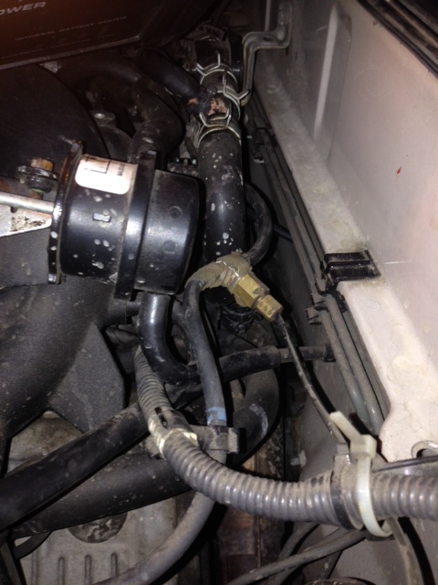

Hey guys, before i go ahead with this little mod just wanted to clear something up. I have been reading what i can on it and people mentioned tapping the the boost port line with hose from the FPR. The hose i have plugged into the boost port runs down the engine into another fitting and it looks like a small vacuum line is T'd off of it to go to the boost gauge. Do i T into the line that the boost gauge is connected to? I thought i would be tapping directly into the boost gauge line but it seems way to small.. I am clearly not experienced with superchargers and don't want to mess anything up until i can gather the moola for the 7th injector. Ive attached a pic of the line coming out of the boost port and where the boost gauge connects to it. Thanks!

You should put a T on the hose that comes out of the boost port, I'd say fairly close to the boost port of the supercharger. And then the line coming off of the T goes into the fuel pressure regulator.
