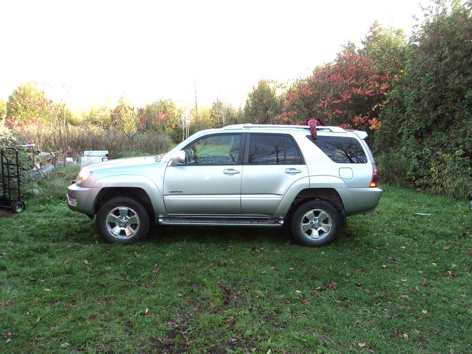

My V8 seemed to level out pretty well, and $706 does seem alittle high since the kits is only like $50. I didn't follow or make write-ups but if you want to tackle it yourself I'm sure we could talk you thru it. THe only really pain in the ass for you is disconnecting XREAS, its not impossible it's just a pain.
Heres mine after

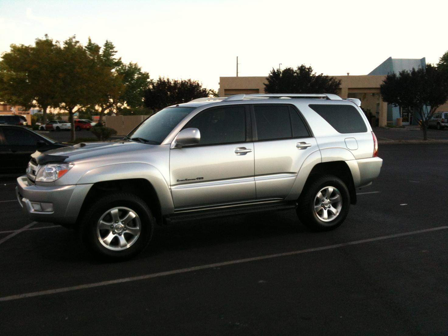

About the spacer, some like it, some think it puts the nose too high, and it did on mine. It looked like it was sagging in the rear. I didn't like it, but I wasn't about to uninstall it, so I put a 1.5 spacer in the rear, so I now still have a little rake again. It wasn't the rake that I didn't like, it was just the fact that the space in the front wheel well to the tire was so small, and overall it the 4Runner looked squashed to me. It didn't look right to me.
Here a pic with 1" Budget Boost and 1.5" in rear.
