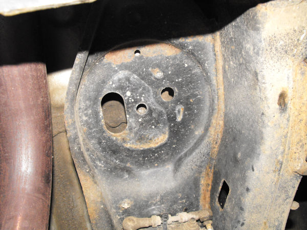

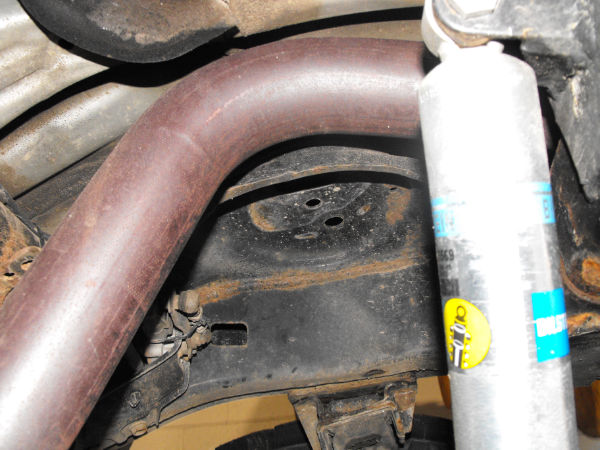

Just a thought... Why not keep everything stock but just grind off the upper airbag mount, and weld it back a couple inches lower, its recessed all the way up at the high end of the chassis alowing close to a four inch lift if you really wanted.
