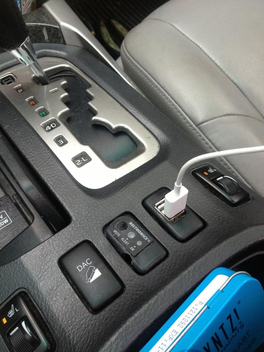

This is my first real post, I just wanted to show you what I did
-added a radar detector mute button to a switch blank and hard wired the detector to a mount on my mirror. The LEDS still work too. I basically took apart the cigarette plug cord and tapped it for power, and extended the wires for the plug to the detector unit. the side hole on the blank was from a previous USB cable that I had coming out of there for my iphone. I'll be filling it with black silicone caulk eventually.
-added a dual USB charger to the other blank
to mod the blanks, i just used a dremel and super glue.
tapped both into the normal cig lighter plug as the "unused one" that ive read about is powering my GPS.
I can do a more detailed write up/post more pics if anyone is interested.

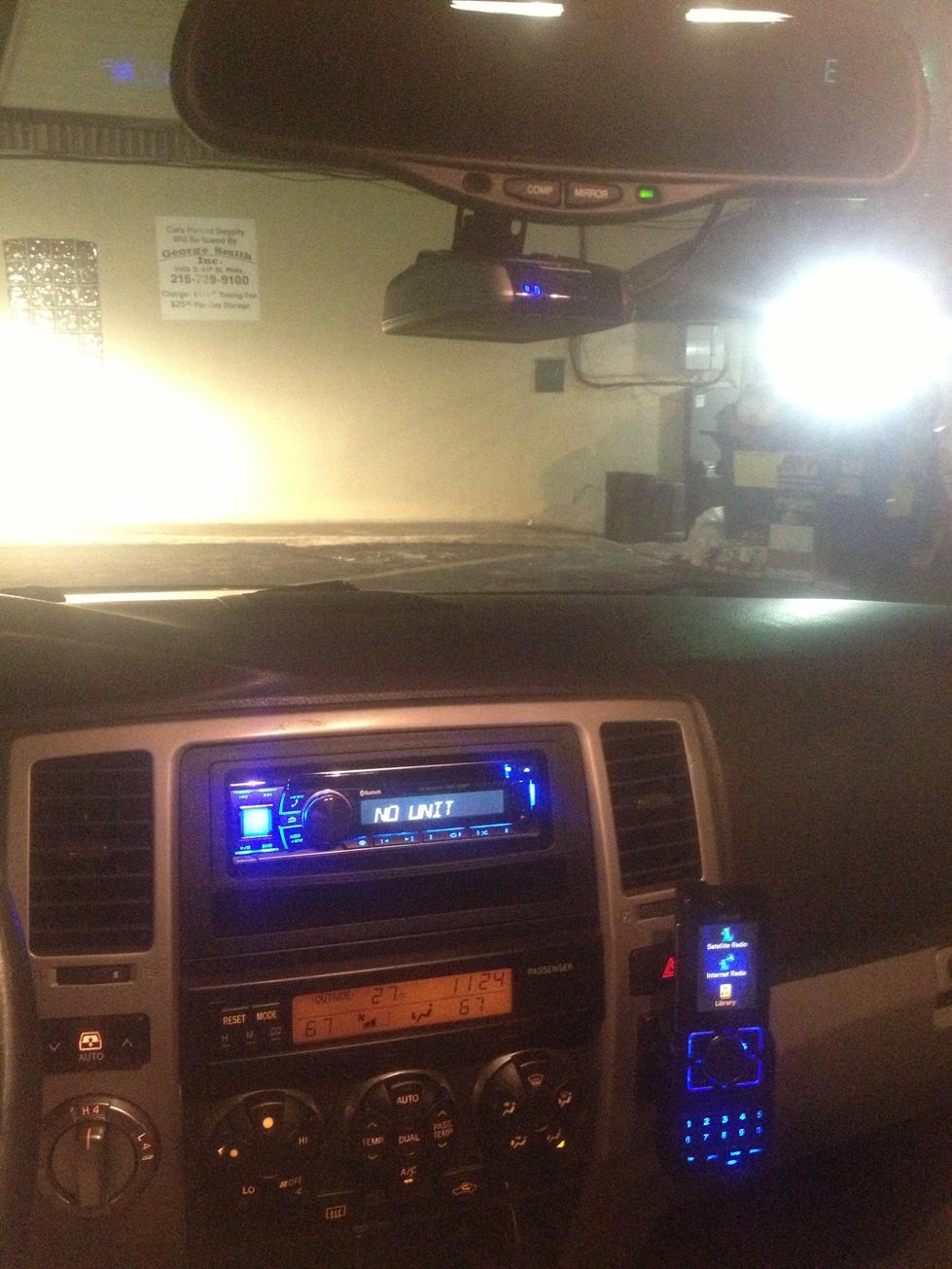

heres a pic showing the radio and the radar detector which is mounted on the mirror with the remote right next to my hand on the switch blank. The BT mic for the radio is mounted right on the plastic where the oh sh*t handle would be for the driver. I'm thinking of eventually dropping the headliner a bit and snaking the mic through so that it clips onto the headliner by the moonroof. My moonroof is busted and beyond repair so it wont interfere
