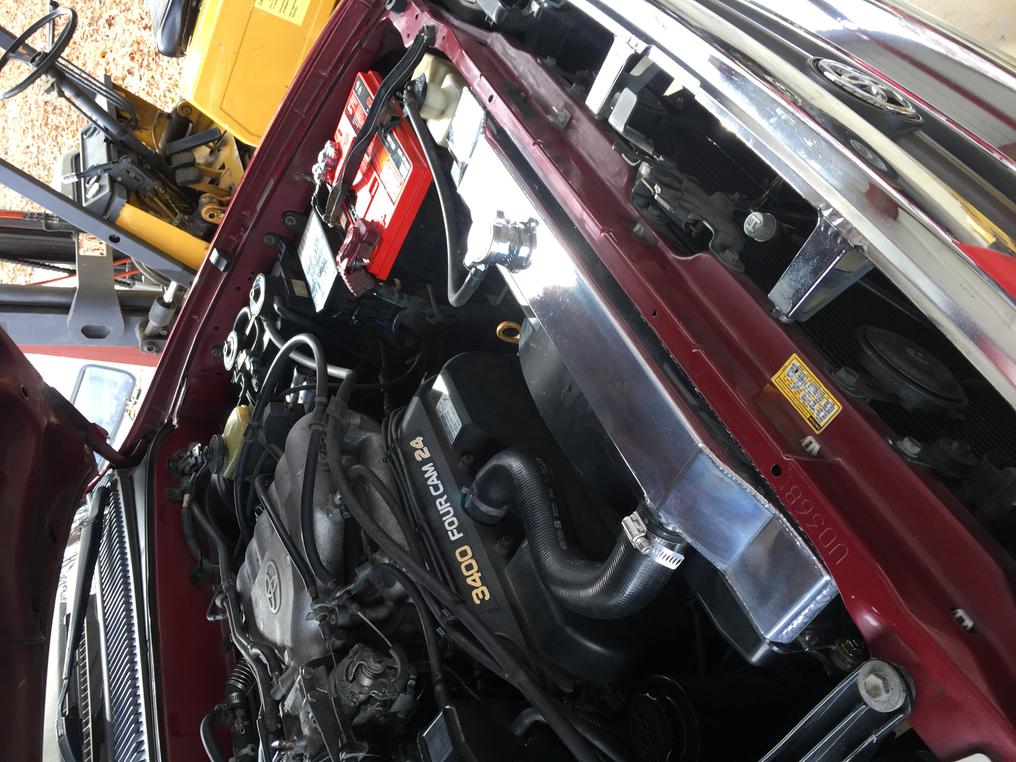

Unless you want to do away with the plastic crimped on tanks. This 3row one in mine was $202 and a two row one is around $160. It fit great and works great.
