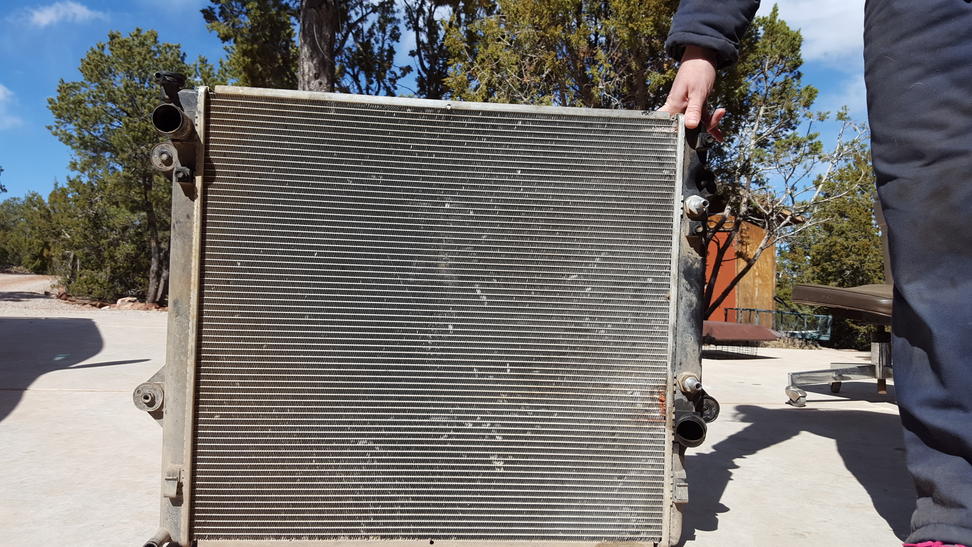

Sorry for not being clear. My ATF cooling nipples are on the side vs what that pic depicts.
Thanks for the links. Let me see what it'll cost to have a shop clean/repair it.

Took the radiator to the radiator shop and the leaks are at the side tank gasket. They said that these radiators are basically disposable since they may not take a gasket replacement well. Given that this unit served me for 318xxx miles, I splurged on a new unit for $170 out the door. This is on par with the internet prices but I didn't get a Koyo unit, which is what I wanted. I'm about to go to Death Valley and didn't want the stress of not having a 100% operational engine.
On a side note, I was thinking about replacing the tank gasket myself as the process is pretty simple. But for the life of me, I couldn't find the tank gasket on the 'net.
