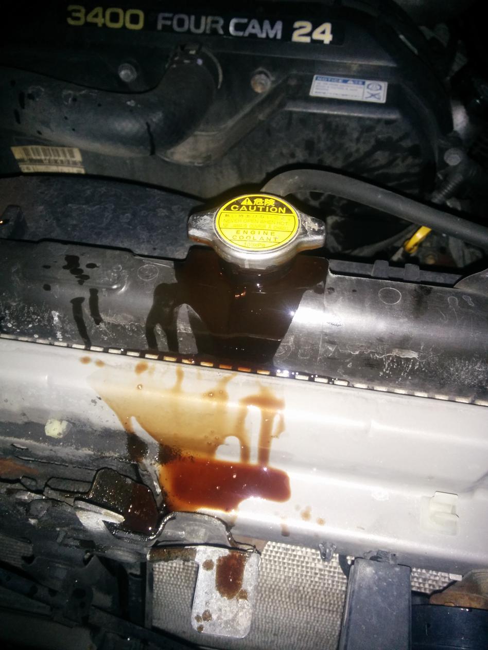

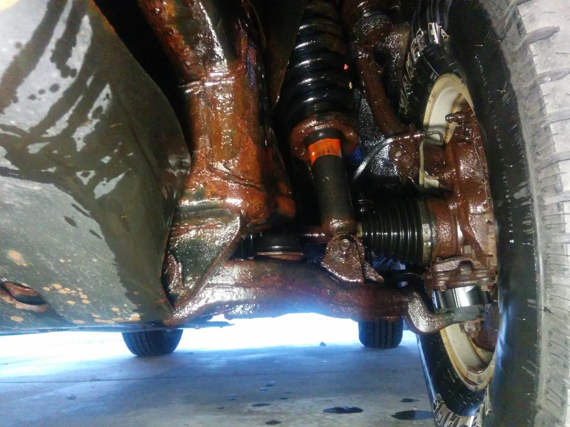

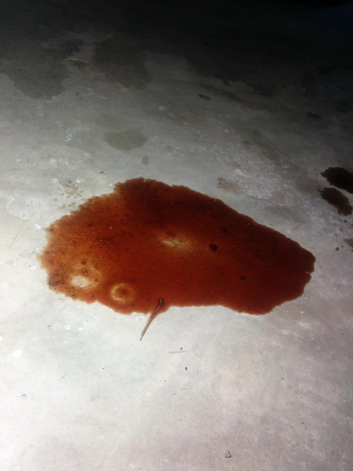

Got to my sister in-laws to pick up the baby notice a puddle of red-brown under the front drivers side wheel. Further inspection showed what looked like a fluid explosion in the wheel well. Thought it was a brake line but brakes were fine and fluid was at level. Drove the short trip home with no issues but immediately got another puddle. Determined it was radiator fluid. Opened cap and overflow and it seemed thicker as it overflowed out of both the radiator and the over flow tank. It also was not hot. As if there was no flow through the system. I realize this is all preliminary but any advice or been there, done that, would be appreciated.

It appears the trans cooler lines gave way. Coolant mixed with atf caused an overflow. 4R never slipped or missed a gear. Had to get it back on the road and bought a spectra rad from autozone and five gallons of Dex III atf. Installed new radiator, drained the pan, and flush out tranny. Did it 2 quarts at a time. Add two qts, pump two quarts. Could tell the atf was spent and it spit out what I would call a foamy version of atf fluid to start. After about 4 1/2 gallons it was pumping the clean fluid. Crossed my fingers, prayed, and took it for a ride. No issues. Shifts very smooth, doesn't slip, and runs a little cooler. Didn't get to use koyo rad like I wanted but had to get it back onvtge road. So far after three days and about 250 miles she seems fine. Hope it lasts! And external tranny cooler on order!

Seeing this on a daily basis at work at our Radiator shop first try and new cap from just what I'm seeing with it leaking at the cap. Even if you get a new Rad after it is good to have a new cap also.
Next take it some place that can run a pressure test on the rad to find the leak.
After that you will know what is up for sure, if you need a new Radiator I think the cheapest place to find a Denso Rad is going to be Amazon just FYI. I can't even beat there price at cost.

That pic of overflow is after opening the cap. There was no leakage at all from the cap prior. The vehicle never overheated. I'm just praying its a hose leak (haven't done a thorough inspection yet) and not the dreaded milkshake. No foaming of fluids. I'm not really sure how the radiator fluids on the 4R's looks when comparing it to the milkshake issue. Praying.........

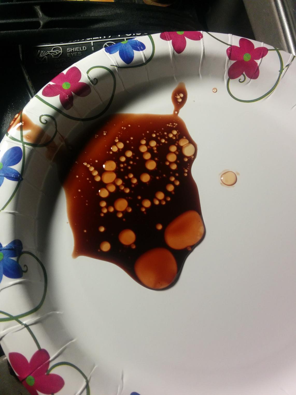

Pulled some fluid from the overflow. Looks like a clear mixture of fluids. Fearing the worst.

EEEWWWWW...
That fluid definitely looks confused...
Probably the trans cooler portion of your radiator has broken loose causing the Gooey mess...
Subscribed...curiosity of what the mystery mixture is. Whatever it is...I don't think you're going to get off cheap...ie., radiator hoes or cap.

Going to replace the radiator, top rverything off, and have the tranny flushed. Never had any slippage in the tranny. Hoping for the best and hoping I caught it early.
That's great you're back on the road again...with no trans problems. Imho...round the 500 mile mark, I'd flush your transmission again. Just for some good cheap insurance. That way you know you got all the "bad/contaminated" fluid out?? Just a suggestion?!?!
