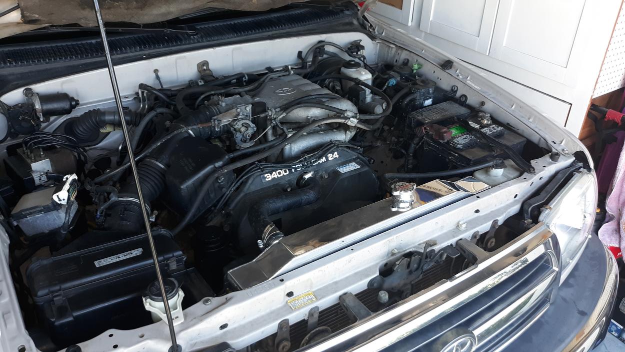

Champion CC1998 install
2000 Toyota 4Runner SR5 3.4, 225k mi Champion CC1998 install - Here is a photo after installation. From reading other posts and watching YouTube videos, I wrote down the steps on radiator removal from watching the videos..When I took the skid plate off, it was a mess. Cleaned it up and painted it black. .I don't believe it was the original radiator, it didn't have any Toyota mark on it..plastic and aluminum, split on the seam at the top, in pretty nasty shape..I did most of the work myself, and paid a mobile mechanic $70 to help me with some of the install...we had to bend the hangers straight a little bit on the new radiator to fit, and widen the mounting holes a little in the truck with a drill... I knew this would be the case from watching the videos and posts on the Champion 1998 install.. Also had to bend the hangers straight out of the way on the skid plate as well because the new radiator is a little thicker and not quite enough clearance to hang it. All in all, I'm happy with with the install. I hope this info helps someone, like the info helped me.
