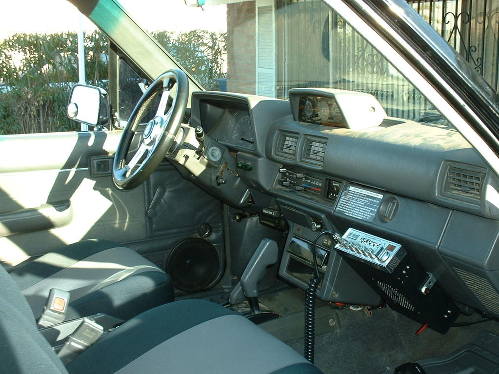

If you didn't have to have the glove box you could mount a radio there. I was getting interested in HAM because I would hardly hear anyone on a CB. But wasn't sure where to mount one. This is the first vehicle I've owned since the 70's without a CB. Had a Cobra 75 in it for awhile. I was thinking of making a mobile one for a full size CB in a toolbox or cooler that I could set in the seat when I didn't have a passenger. Have the antenna and power and ground ready to plug in. I saw one installed on the glove box door. Here:

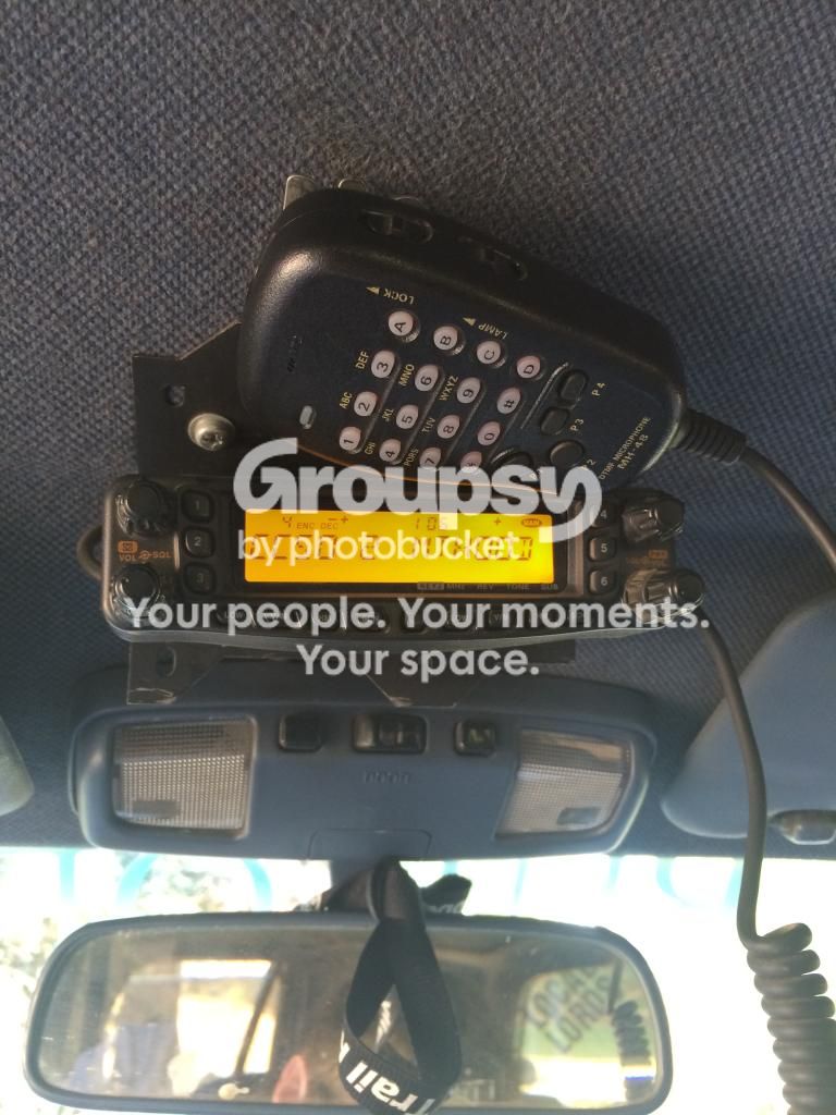

I have several radios capable of ham operation. My main ham radio I have on my headliner. It is just the faceplate so it is really small (yaesu 8800r). The main body of the radio is under my dash.

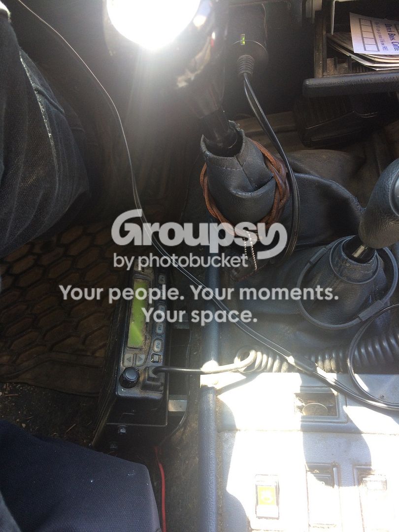

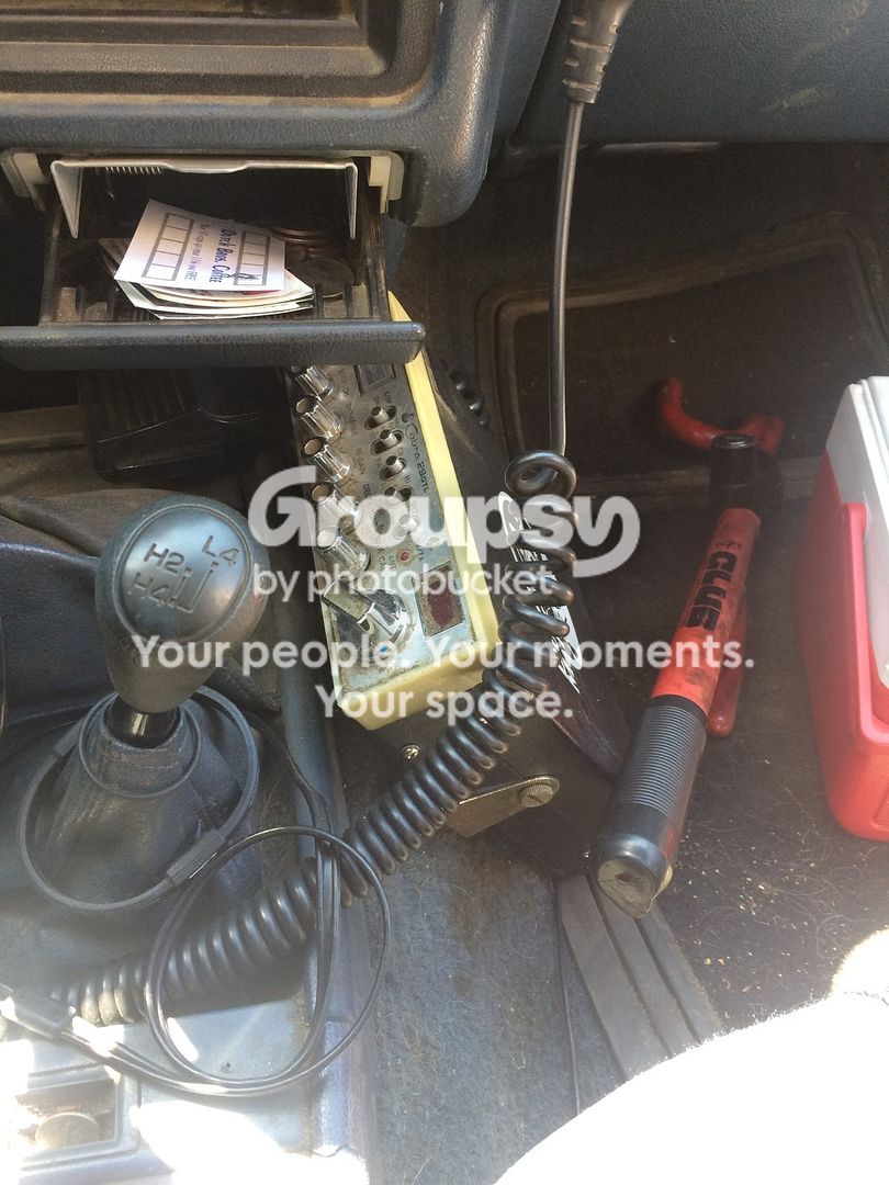

I also have a commercial vhf (icom 521) on the left of my trans tunnel, and a CB on the right.
Sorry for the messy pics.
