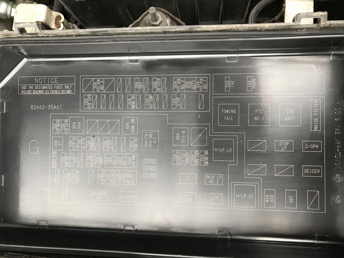

Here is the diagram on my fuse box cover. [MENTION=83083]rigtec[/MENTION]

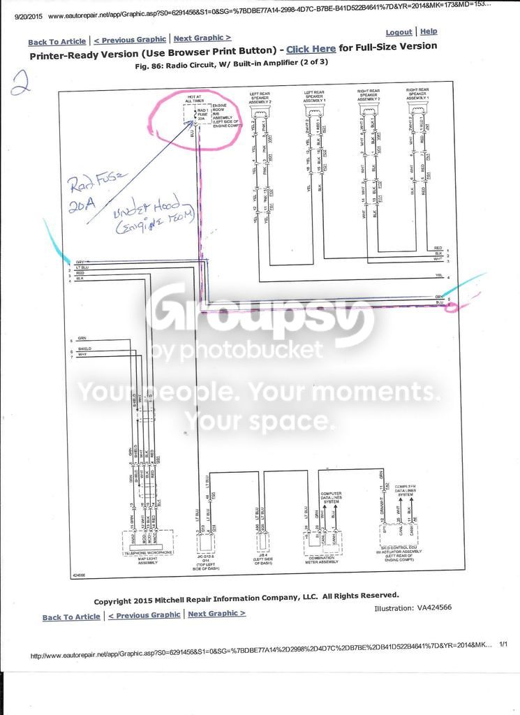

Okay UBWine09,
See the fuse marked by the pink circle RAD-1 20A 'HOT AT ALL TIMES':
Scan.jpg%20Radio%202.jpg~original
..."Let me know if you have any trouble viewing the photos (Photo-bucket issue)"
rig, cheers
Okay I see your HOT AT ALL TIMES fuse. It's like mine; says: 30A AMP in the center column...
I thought yours was a 2014 4Runner? Anyway: pull the 30A AMP fuse and leave it out for four hours and that should do it!
cheers!
