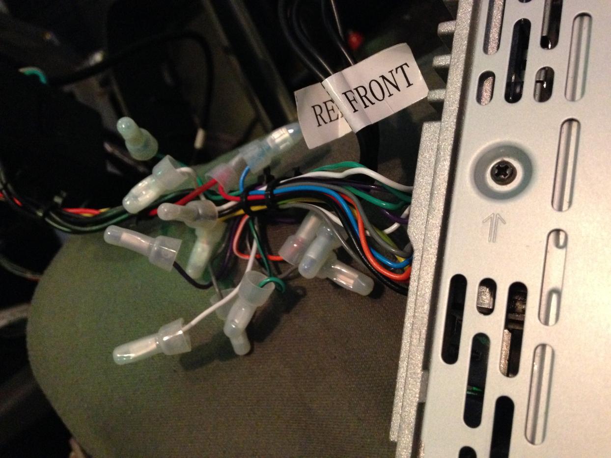

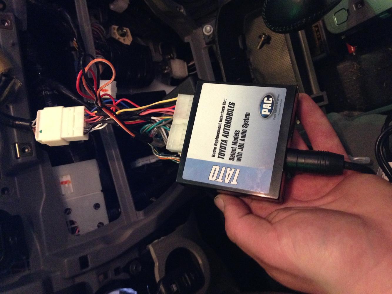

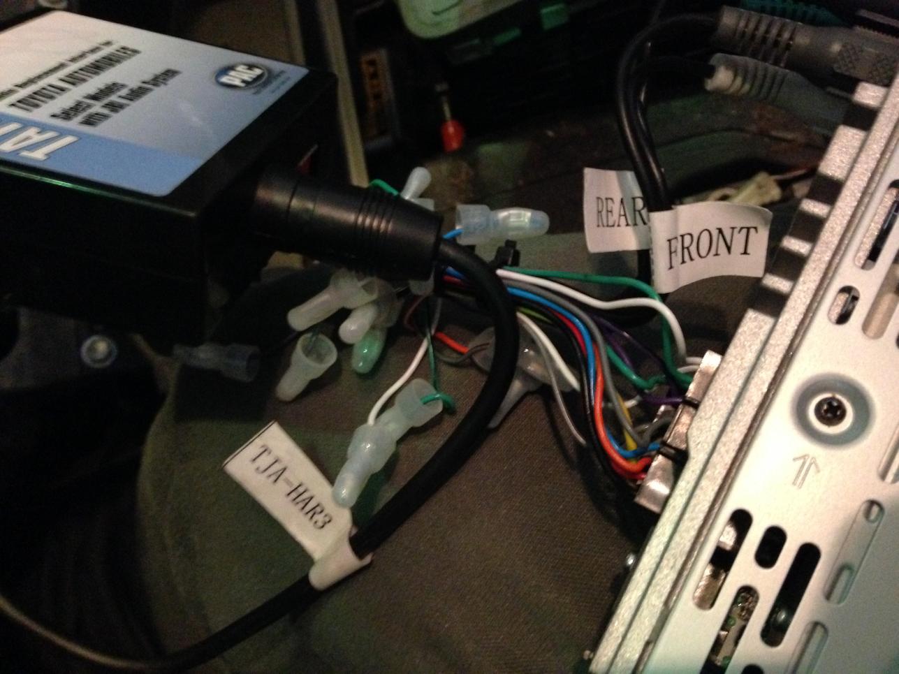

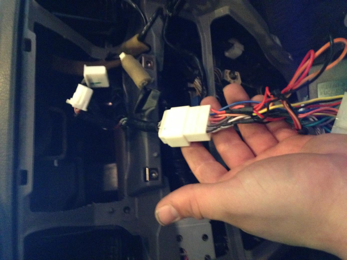

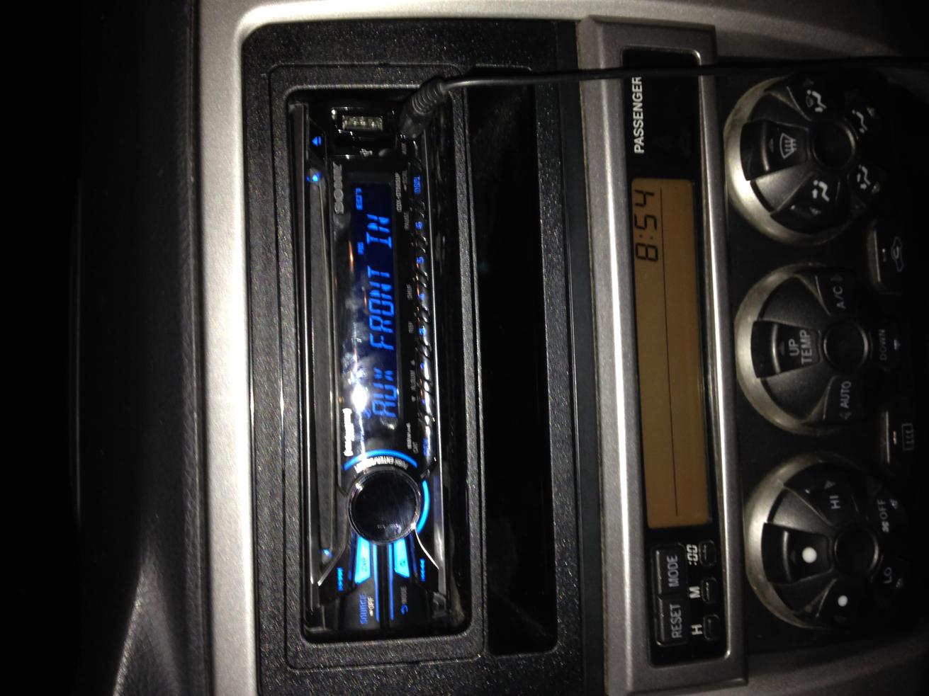

Here are the pictures of the radio and how it is wired
Hey man, the problem I had was with that box in the first picture. the TATO adapter box thing. you could try another one of them. If it still doesnt work with that, I would think the next step would be getting a new amp, which if you're going through that trouble I would guess it makes more sense to go aftermarket. I don't really know too much about that, but do know that it will help you down the line if you decide to do any sound upgrades at all. The TATO adapter is just a workaround to get the factory amp to work, and while it is the cheapest way to get an aftermarket head unit in there, it doesn't give you the best sound quality/control. I have the same adapter pictured and my stereo is good enough for my ears, but if I was faced with your problem I'd probably just get an aftermarket amp rather than continue to mess with the factory crap. You might want to take it to a local stereo shop and talk with the guy there for a bit. Sometimes if you're nice and are willing to shoot the shit with the guy he'll take a look at it and help you diagnose it for free. Can't really tell you much else just by looking at pictures.
I think that its a problem with the amp not being sent a signal to turn on. Maybe chekc the amp-speaker harness connection at the back of the truck? Maybe try swapping the tato to another new unit to eliminate that as the cause
The PAC comes with 4 RCAs - does your single din radio have 4 RCAs in the back? AKA are all the RCAs plugged in? Any line output converters back there?
