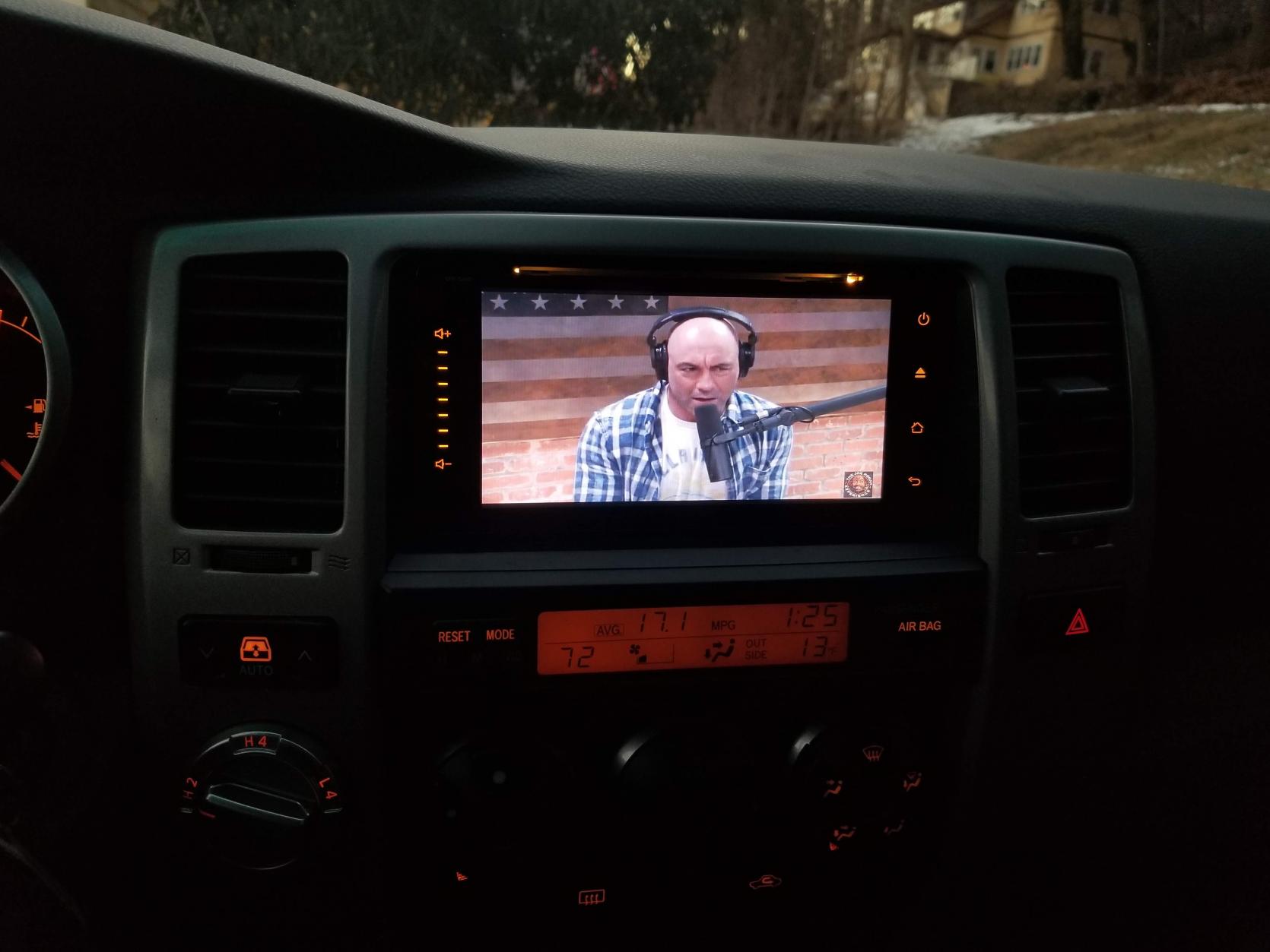

I went with a full android unit. I was perfectly happy with my stock radio in my sr5 until I read this thread....
I reviewed it in another thread, but in short its plug and play and perfectly fits the stock opening without the cheesy faceplate kits. Ordered a "Plug and Play" Android headunit
Lots of awesome upgrades on the xda forums. I installed a ROM and the interface is amazing. Looks stock and its not that expensive. I have some tips and tricks on the install (like how to keep good radio reception and deal with the diversity antenna wires). If anyone needs help with the install shoot me a PM.

XTRONS headunit looks good
Nice install with the XTRONS. Very tempted to go that route too.
Does it support Android Auto, either wired or wireless?

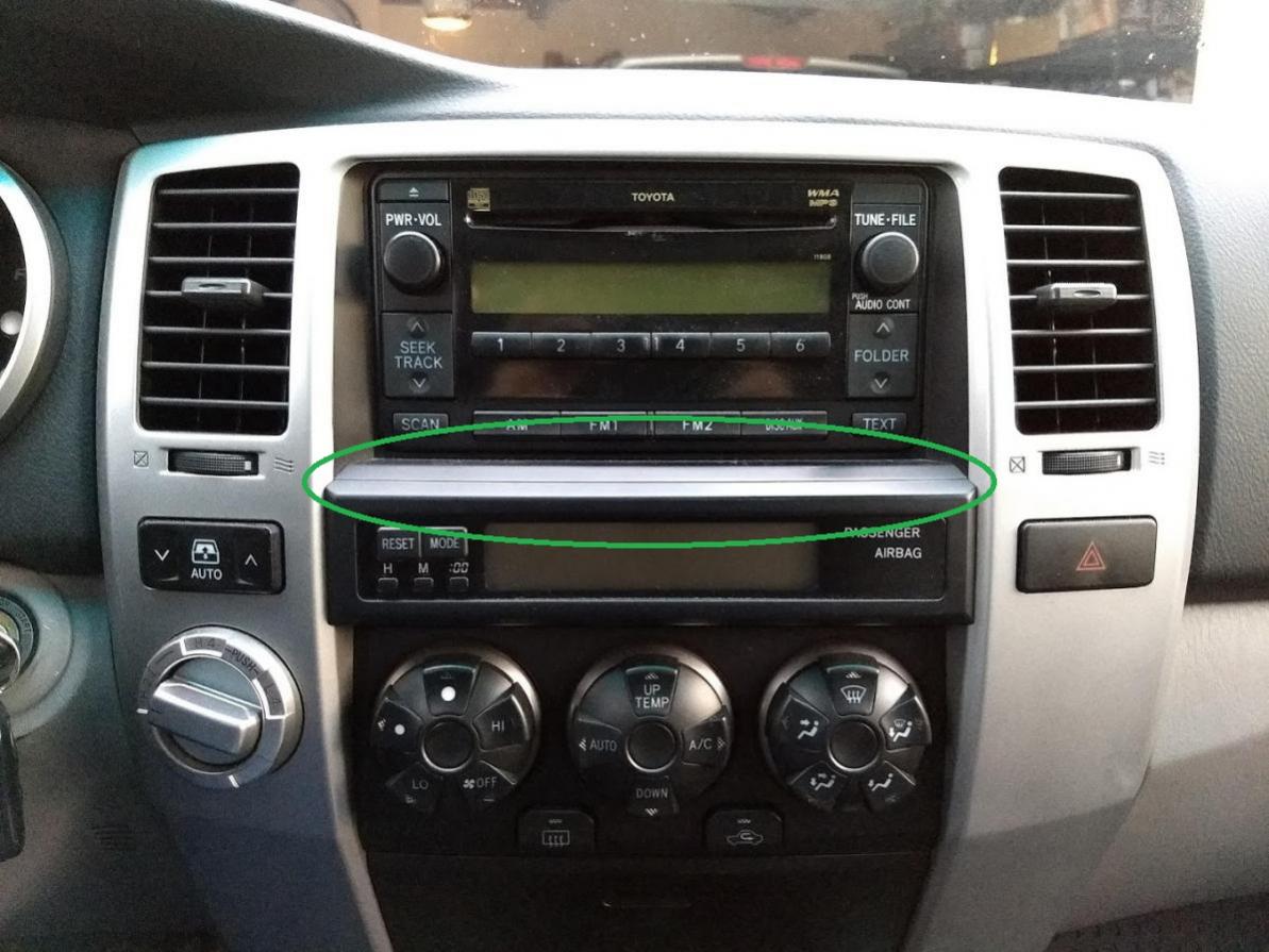

06 SR5 w/ non-JBL radio
take a pic of the current radio in your car, i can tell which kit you will need to make it look right. that poster has a jbl radio opening, its different from the non jbl 4runner.

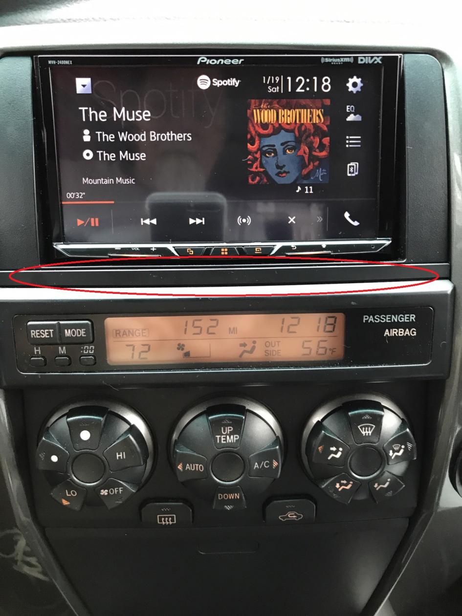

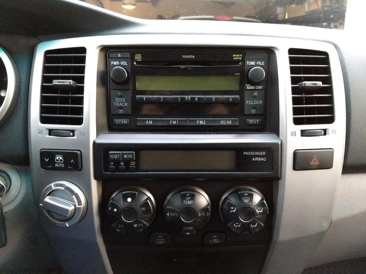

My SR5 V6 has non-JBL radio, no nav, no steering wheel controls, no cd changer. The failing volume knob randomly adjusts volume up or down, regardless of the direction I rotate it. So thinking about replacing it with a Pioneer AVH-2440NEX or a generic Android unit.
It has to do with the little strip of plastic between the head unit and the multifunction unit on the models with JBL radios. See pic ...
That little strip isn’t part of the trim kit ... it’s actually part of the multifunction unit.
JBL vs non-JBL
Ahhh, now I get it. I totally thought that strip was part of the trim kit.

For other folks looking into this, here are two pics with the JBL vs non-JBL difference highlighted.
First pic is MrEMan's pic w/ the extra piece of plastic from JBL 4Runners circled in red.
Second pic is mine w/out the extra piece of plastic from non-JBL 4Runners circled in green.
I'm sure it can be made to, but it would be a step backwards IMO. I loaded a ROM from the XDA forums (Malayask's 3.2) and really couldn't ask from more functionality.
