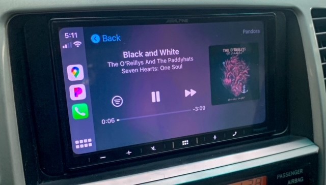

Pioneer. Easy install. Love having gps.

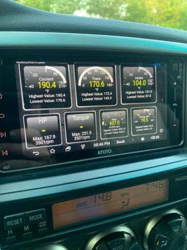

ATOTO A6 Pro for Toyota w/OBDII Bluetooth adapter and Metra TYTO-01 JBL amp harness. Steering wheel controls and OEM backup cam directly wired to the HU. No faceplate needed.
Digging up an old post but have a question. You didn't have any issues with the factory 6V camera wiring directly into HU? I'm trying to figure out the most "plug and play" solution to add Carplay to my '08 w/ factory Nav while retaining the factory backup camera functionality. This seems like a pretty good option.
That's how I did mine, no issues
