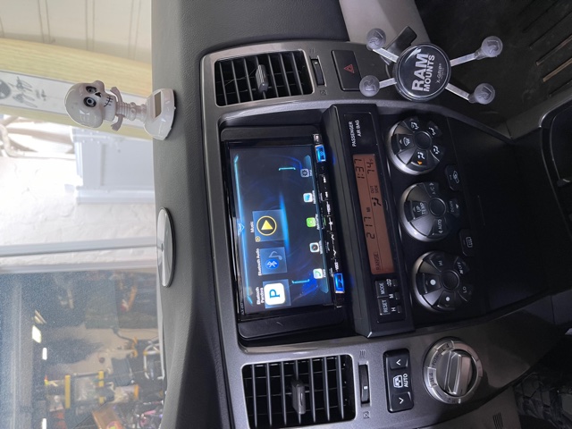

I went with an Alpine ILX-207 from Crutchfield. I wanted CarPlay, a backup camera and to be able to use my steering wheel controls again. It does what I need it to do now.

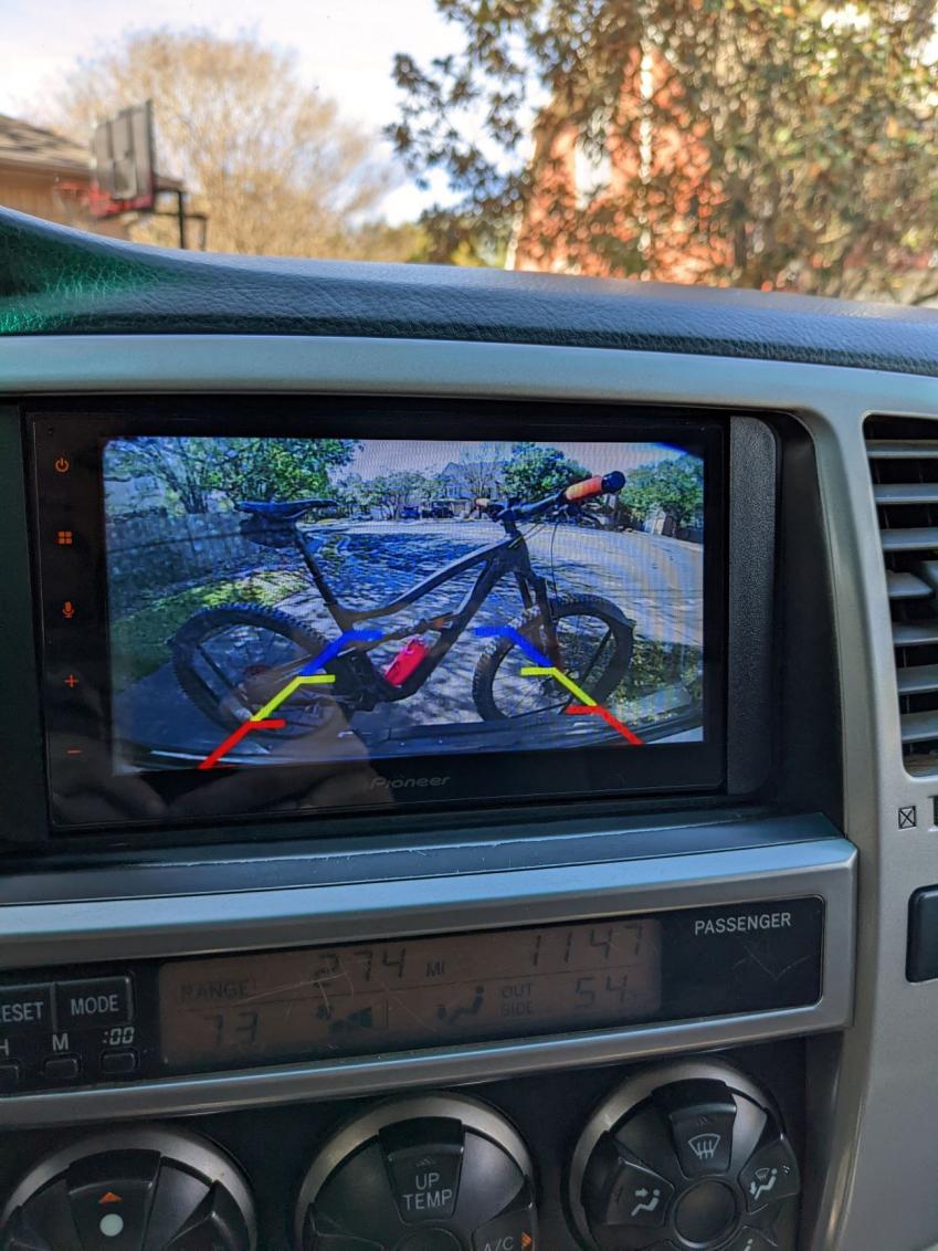

Installed a Pioneer DMH-1770NEX this weekend. Actually installed it 3 times because I'm bad with directions (forgot to attach the mic first time, plugged backup camera into wrong input second time).
The unit was cheap ($300 at Best Buy on sale), has capacitive touch screen, android auto and input for the backup camera. Looks good, works good but sound is just ok - I'm using the factory speakers and the old factory headunit (non-JBL) sounded richer. I don't know if I wired something up incorrectly (all speakers work and sound similar, and the color coding was easy to follow) or if the factory unit was designed to work better with the factory speakers and I just need to adjust the equalizer more and/or replace the speakers.
I appreciate all the "how to's" on this forum as it made the radio and backup cam install (along with everything else I've done) easy!
