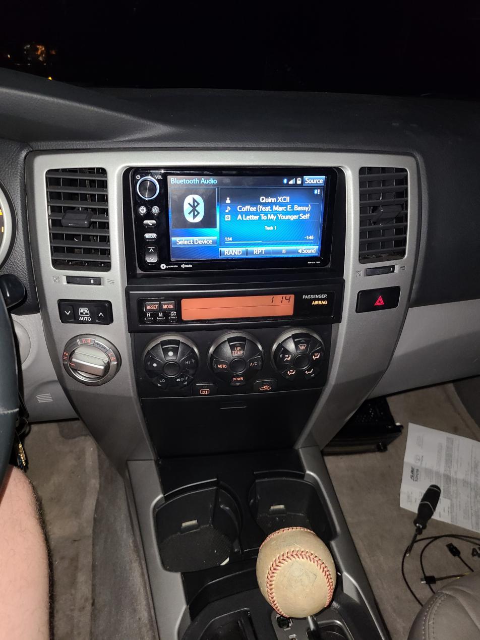

No pics right now, but I installed an Alpine ILX-W650. Capacitive screen is rad. Auto dim is rad. Screen color of backup camera is rad.
Not rad: rampant grounding issues in my unit. I originally installed it with just the factory speakers and things were awesome. Then about a month later I had time to install my system (2 4channel amps with door woofers and tweeters, DSR1 signal processor for a fully active setup). I spent the next two weeks scratching my head because I couldn’t get sound on the right side of the car! Result: the right side RCA channels are toast on a brand new unit!!!! Bought it from Best Buy instead of crutchfield like I normally would because I was in a rush before a road trip so now I can’t return it and I have to send it to alpine for repair.
Making it work for now because the DSR1 can take speaker level inputs so I swapped to that for now.
I saw grounding issues because now that I have the speakers working, I have an intense noise floor I can’t figure out. I tried several different grounding configs and all have the same results. My guess is the ground in the HU is wonky and it also what’s affecting the RCA outputs.

Did you anything other than the head unit for the install? A harness or brackets or anything? I’m planning on installing the exact same head unit after seeing yours. Thanks.
Surprisingly no. The unit came with it's own wiring harness and so you just splice the correct colors with the existing harness in your dash. I have more photos in an album on my profile. But the existing bezel fit perfectly with it and that was it. I also installed a steering wheel control adapter, not shown, but that was pretty straight forward enough.

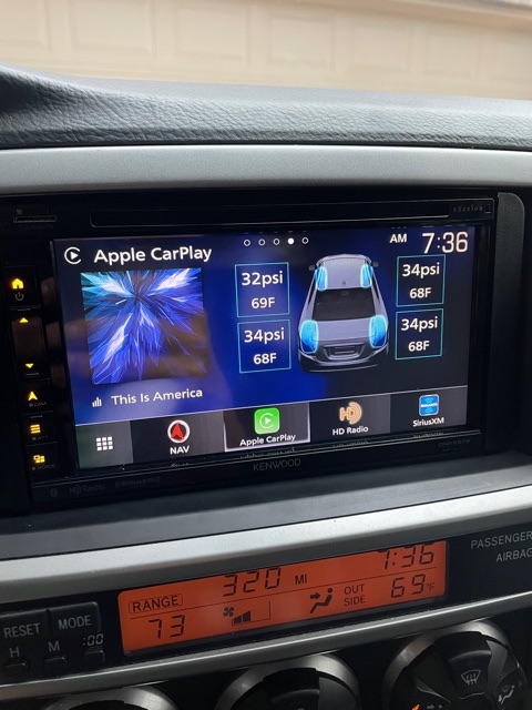

Kenwood DNX697S
Had this installed a month ago...upgrade from a Kenwood 891HD head unit. Love it.

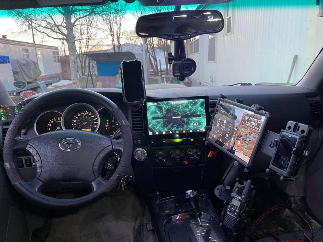

JVC 10" inch unit, alpine speakers front and back, 10" kicker sub and Alpine amp
