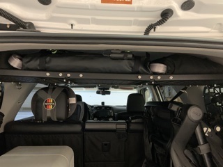

I store my recovery on the shelf, no issues getting to items or risk of it falling out. It will cut off part of your rear view vision, but not too bad.
Recommend attic if just holding blankets, jackets, etc (Raingler or BROG). Had the Raingler before and it worked very well, solid construction.

I installed mine, I can't believe how heavy duty this thing is. I definitely wish the headliner was black, I have already accidently slid things into it and made marks.
I installed my shelf about 2 months ago. This stuff is heavy and a pain to install. After using it for two months and thinking about it, I wish I had gone a different route. If it were easier to adjust it would be an awesome addition, its just such a pain to unbolt everything only to adjust it up or down. Oh well, you live and learn...

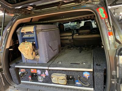

Since i didn't want to make the same mistake again by buying a product that i didn't want or wasn't designed properly, i made a homemade shelving unit as a testbed to see if i needed a molle/modular shelf system, similar to the rago modular shelf, and after camping in my vehicle, i have come to conclude i need this shelf in my life.
I picked up a blemish versions since i didnt want to pay full price. Hopefully, i receive it soon.
I plan on setting it on the highest setting mainly since i run a fridge, and a drawer system, and i found that the space above the fridge is useless space. So a shelving system is good for utilizing that wasted space.
So while camping in my vehicle, i wanted a place to put jackets, clothing, or weird shaped items up there, while i slept in the vehicle. I also run a power wire to the fridge from the top down to keep the wiring from getting chewed up by my fridge slide. I also use it to hang camping lights. If you camp in your vehicle, you will soon find out you do not have enough space.
While driving, i needed a place to put my bedding up there. I sometimes even put my portable shitter seat up there. Anything oddly shaped goes up there.
Day to day uses, a good place to put a extra jacket, flip flops, doggy gear, but you can put heavier items if you so choose.
When you are offroading, you want something beefy. My homemade contraption sucked going over corregation, washboards, and woops. Either screws kept getting loose, or the metal would flex causing all sorts of a racket or stuff would move due to the vibrations in the thin pot metal. I had my engineering buddy go over my setup and he agreed, to solve my problems, I had to use stronger metal/steel than home depot shelving or everything will rattle apart due to the harmonics. The thing is i bought the strongest shelving home depot had and it was still to flexible under offroad conditions. So i started looking at rago again.
So is the price of this product steep? The answer is yes, but if you have a reason to buy it, its definitely worth it. You can definitely find some good uses out of this product, or you can just sell it.

installation wasn't easy. i first mounted all the fasteners upside down because it was easier that way doing it by myself, then once done, i flipped the fasteners to the correct way. It also, goes will with my cargo net (not pictured) and clears my fridge and drawer system.
