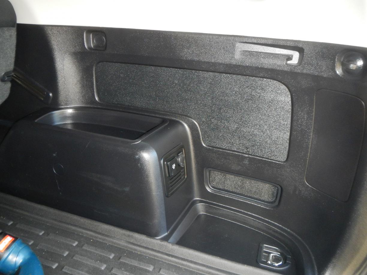

Hey, thanks for this idea. Those open holes always drove me kind of nuts. For my shelter-in-place project I went to my local Tap Plastics store and got a 24in x 24in sheet of 3/16in black ABS with one textured side. It was about $25. I could have ordered a sheet from Amazon for about $16 but I didn’t want to wait.

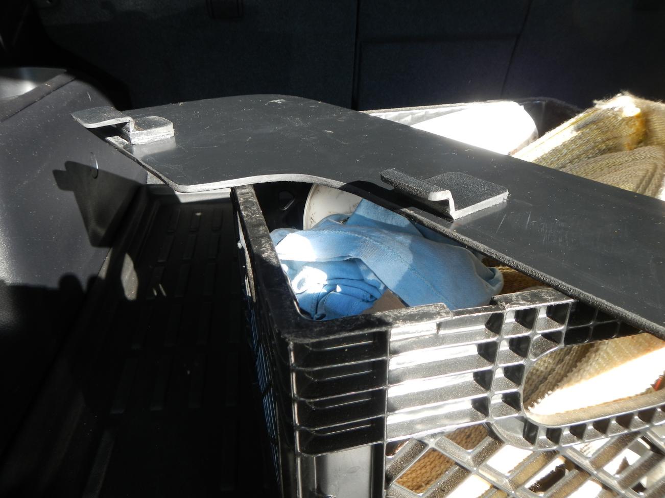

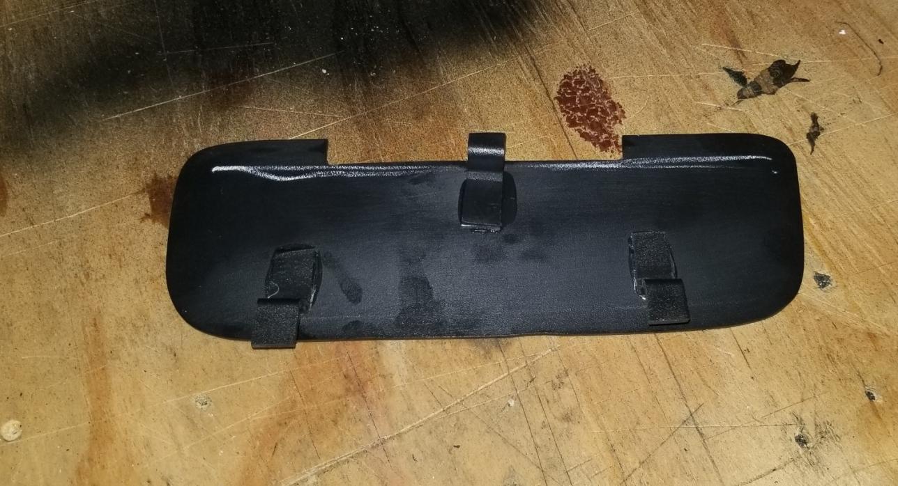

I finally got the ABS adhesive and put the hooks on the bottom of the panel I made. It really holds the cover tightly in the opening so I'm going to leave it as is unless it pops off during driving. If so I'll figure out what clasp I'll use to hold it in. I just cut a piece of the ABS to fit inside of the small opening and slid it in there. It's held in place with the stuff in there. Good enough for me for now at least.
Update: These are the "hooks" that are holding the cover in place.

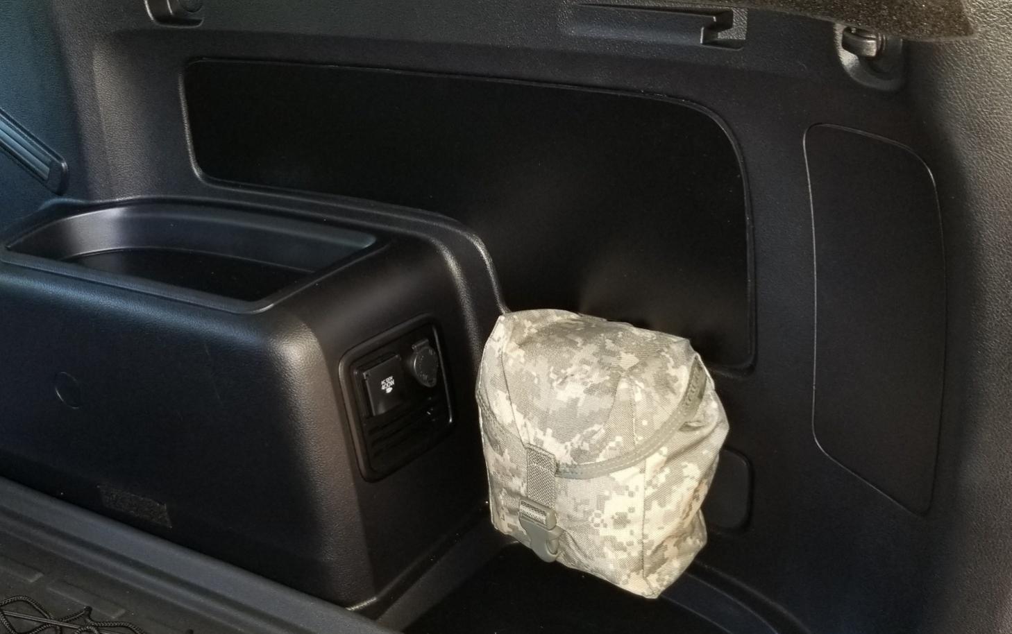

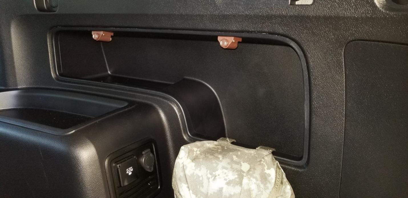

Only real thing i did a little different, was the lower cover. Cut it to accept the MOLLE bag i hang there and was able to fab a clip to hold it in place.
