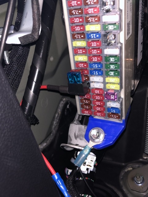

Hey y’all,
I just installed mine and was really unsure as to what fuse to use either. I just used the open fuse on the drivers side. Will this create any problems? Any help or suggestions/pictures of where exactly to place it would be great! The open spot I plugged into is working just fine and I’m having no issues but wanted to make sure I wouldn’t screw something up if I kept it there.
Here’s a photo:
I’d think you’d be fine. The only open spot on mine was any always on spot (I.e. lights would be on all the time regardless of if the ignition was on or not). So I tapped something else
Thanks for getting back to me. I ended up changing it as for some reason the open spot caused my drl’s to not function so I used the acc port. Thinking about switching to my driving lights though so they are only on when they are. Thanks for all the help!
I ended up going through the main firewall gasket (not fun) and using the TAIL fuse in the cabin fuse box. Seems to be working fine for the past week. Not a true on/off switch but I like that they don't come on just with the ignition.

I've got a 2020 that I installed these lights on. I used the INJ fuse first, but the fuse box cover didn't fit plus I don't want the lights to turn on everytime I start my engine. I want them to turn on when my running lights are on, just like they are on my Ford Raptor. I've plugged them into the H-LP RH-LO 10A fuse and they work when I turn my headlights on, no problem. I really want to find the fuse that operates the running lights only and to plug into that one so I don't have to have my headlights on to run them. Does anyone know which fuse operates the running lights alone?
