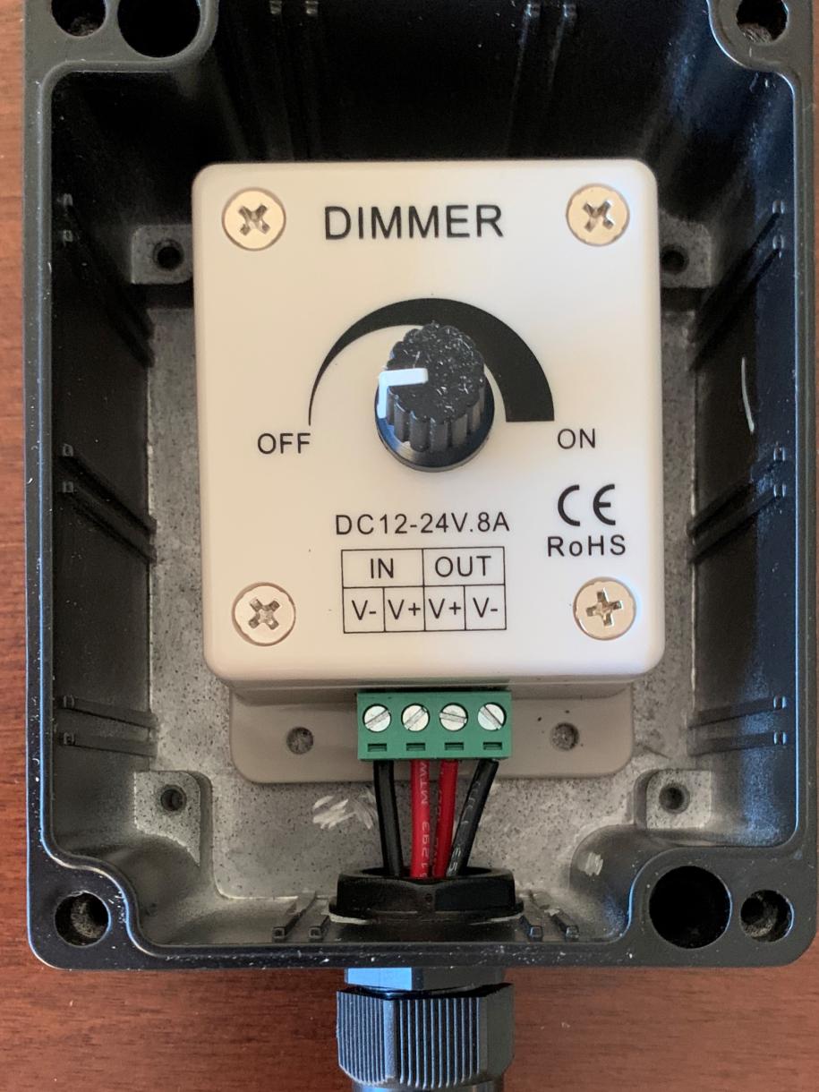

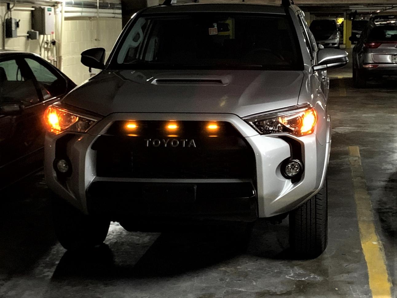

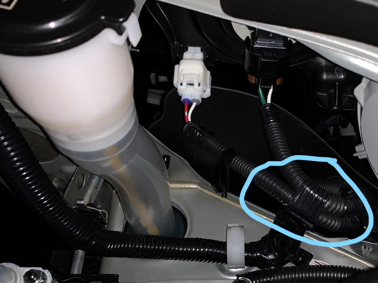

I added a dimmer switch and tapped into the parking light wire.
