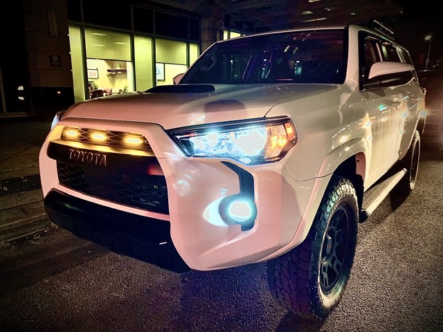

2020 TRDP.. just bought some nice lights on amazon and followed one of the millions of DIY videos on youtube

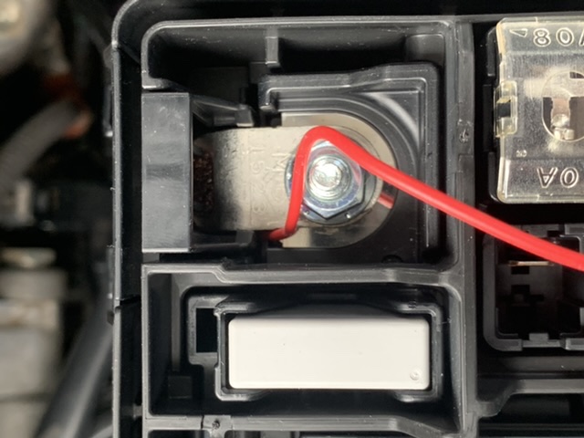

false ... was able to follow a video on youtube, shows you if u remove a bolt, youll be able to install the wire to the fuse re-secure that bolt and then close the lid

I did the same thing. Ran it to the under hood IJN. Used the method of running the wire up through the bottom side by loosing the bolt. Forget the exact video but it’s under runnin for tacos YouTube site. Search for raptor or grille lights on his channel.
There is also a guy on you tube Chris has a 2020 white pro 4runner ran the lights. But he did not do what running for tacos did.i believe he said he has to run the wire differently. I’m going to do on the video from running for tacos did with removing the bolt at the fuse box.

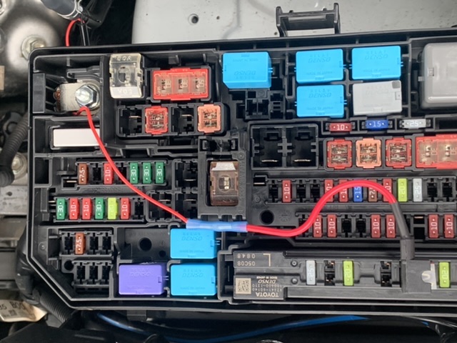

I got the lights in and followed the video you posted. I'm just curious how you got the lid to close completely with the add a fuse plugged into the INJ location.
It sits on the far left, if you are standing on the side of the vehicle looking at the box, and already sits up higher. When I plugged the it into that location the lid will only shut on the main clip and the top left one. The clip closes to the fuse and vehicle will not fully clamp down. Essentially the clip sits on top of this location.

2020 TRD Pro here.
I just ran them to the INJ fuse. The fact that the fuse box doesn't shut all the way in that corner doesn't really bother me at all.
here you go
