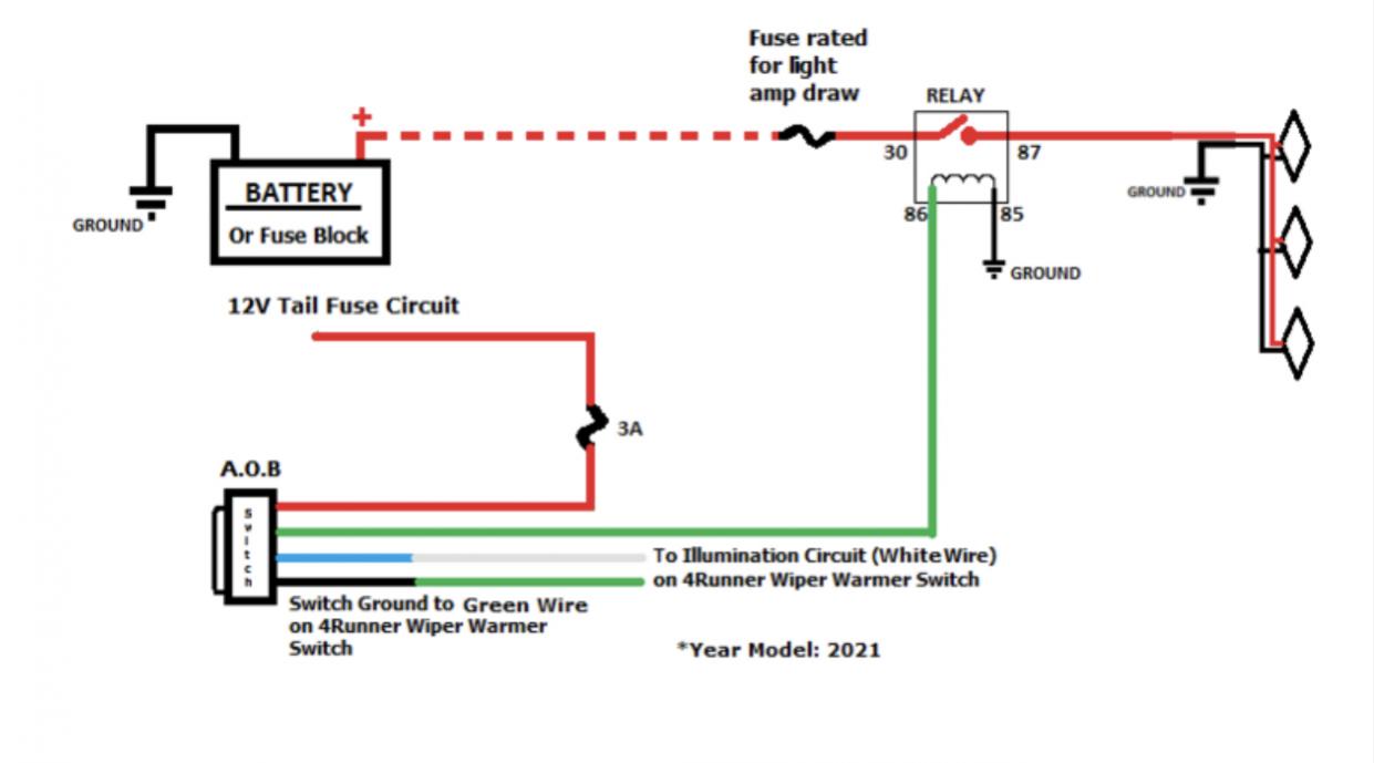

after jumpstarting the truck I have switched the fuse to IGN fuse locator with the 10 amp fuse (see attached fuse cover) So with this set up the raptor lights are on with auto setting all the time, unless the lights are set to DRL OFF or when car is turned off and key is removed from ignition. Hope I’m doing this right. Alternatively I can swap and I see this in the fuse box under the hood but to which fuse???
thanks for your input

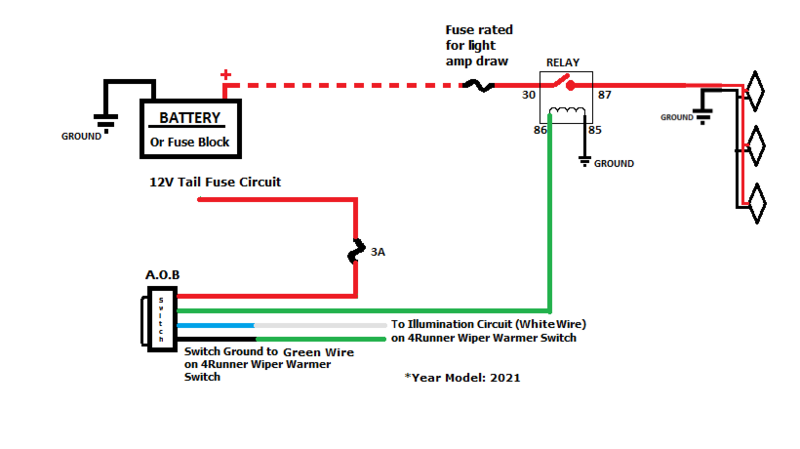

I don’t have any idea why you are having this issue. I have not had any issue with battery drain with mine and how I am powering the trigger to the relay thru the tail circuit.
The illustration below is how I wire my grill (raptor) lights.
I am not responsible for any issues this could cause.
