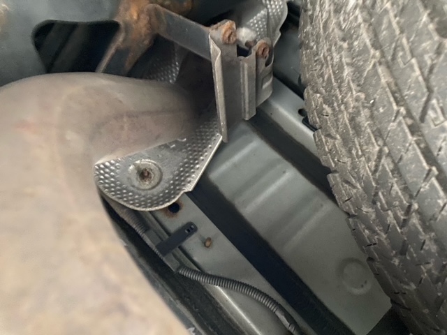

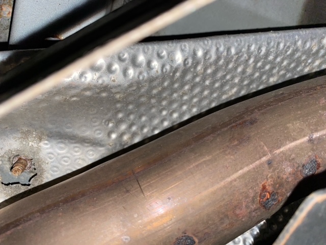

I have a 2014 Limited. Been noticing a rattle coming from the back of the truck esp when idling. Upon checking I noticed there is aluminum looking pan under the truck that somehow got loose. Further investigation looks like it is screwed at various places and one spot seems to have suffered corrosion and is dangling which is what is causing the rattling. Anyone know what this is called and whether it is easy to replace ? Alternatively what type of place fixes this? A body shop?

Thats a heat shield for your exhaust. Won't hurt anything by removing. Doing a quick search I couldn't track it down but I'm sure a replacement is out there somehwere.

any shop with a lift should be able to 1)pull it off or 2)replace it. you could ask them to take it off when you go in for anywork.

Aluminum heat shield + steel bolts + underbody location = prime candidate for galvanic corrosion. Not at all surprising that we're seeing these falling off.
I looked all over the parts diagrams for the truck and wasn't able to find any callouts for that heat shield. Not sure if someone with better access can find a PN but I'm guessing it's not normally a replaceable part.

Ya poorly done Toy. but yes off should be ok , I tried save mine with a larger washer worked for awhile then just shredded off so as ^^ stated !

Don't need a shop. Mine was done with 0 tools on the side of the road and no jack even needed. Now if you still have a couple bolts hanging on, either remove them or take a $10 pair of tin snips and cut it off on an angle before the bolts just so that they are each left holding only a tiny piece of the corner. As I said, it's sharp in places, wear gloves. Time and money saved.
You have to wrangle with it a bit to get it to come out but it's like an easy 10 minute job. It's soft enough you can bend it all around by hand.
Heat shields are there for a reason, so it is best not to remove it. If you remove it, you could have the interior floor get too hot, damaging the carpet or sound deadening (think catching fire!). Fix as suggested above or replace.
I agree that you dont need a shop to do this but OP asked what kind of shop he would need to go to for this so it doesnt appear likely OP would be able to get under there and take it off.

That shield is essential for preventing condensation and moisture forming under carpet due to warm exhaust air vs cool interior in cold climate. I replaced my on 4th gen. Super easy 3 nuts and $90 part. Don't even need the lift, put a cardboard down and go for it.
Important: hit those studs with PB blaster hours before removing nuts so you don't snap them off in process of disassembly.
