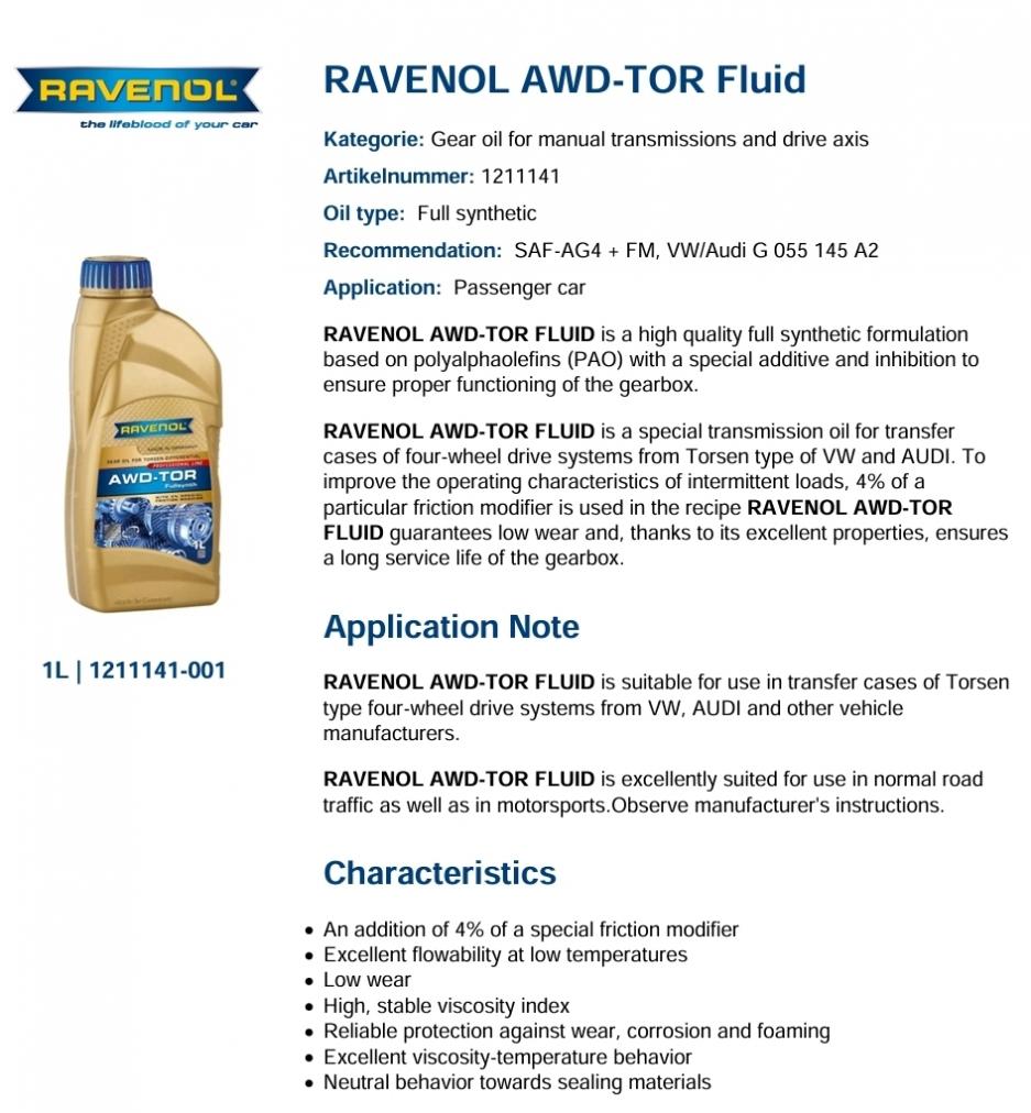

Know this is an old thread, but came across Ravenol AWD TOR oil made for all-wheel drive diffs. Can't find a VOA to compare it to TOY 75W LF, but wondering if this is an acceptable substitute? Their literature (attached) says "for use in transfer cases of Torsen type four wheel drive systems from VW, Audi, and other vehicle manufacturers."
Anyone?
