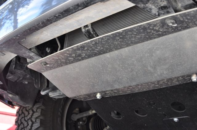

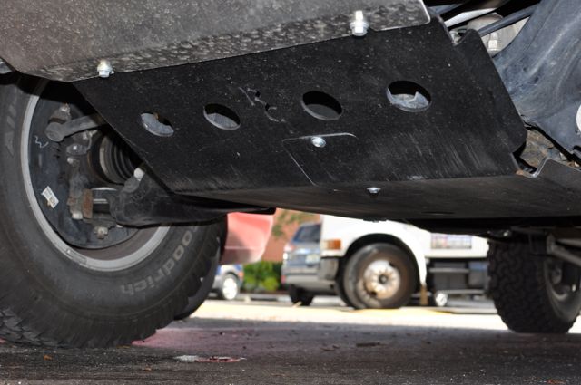

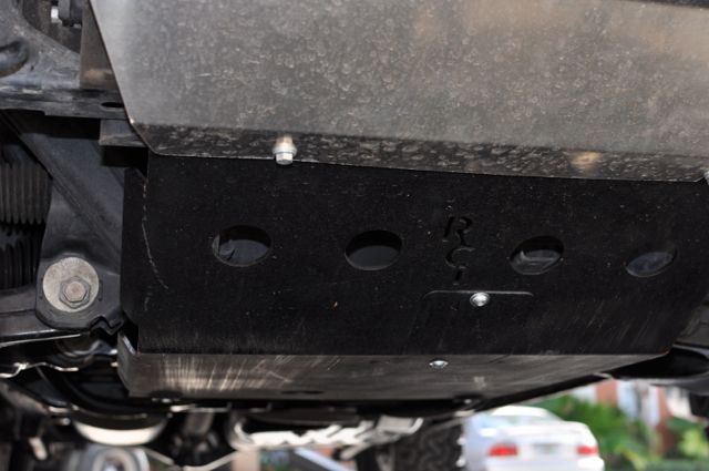

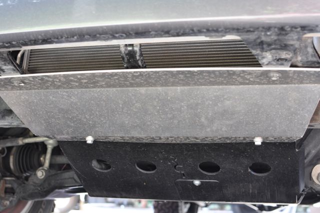

I needed longer bolts up front and even then it took a bit of bending to get it in. But looks like it will perform as advertised.
RCIFrontFillerSkid8_zps0af57a77.jpg~original
RCIFrontFillerSkid9_zps7feb157f.jpg~original
RCIFrontFillerSkid6_zps873a8953.jpg~original
RCIFrontFillerSkid7_zpsa4ee7c27.jpg~original
That is a huge gap, when we spoke I though it was just little gap where you needed longer bolts, did you try flipping it around and see if it fits better. Mine went in like it was suppose to be there and I know John said that it fits for all the model trucks we got.
The pics are without the front bolts in :wave:

You know...something looks off from your pictures, are you running a front skid spacer? Is there any way for you to slide the RCI filler plate between the frame and the skid instead of how you have it installed?

Not really sure what you mean. Here it is all bolted up
RCIFrontFillerSkidOn1_zps0fa4e451.jpg~original
RCIFrontFillerSkidOn2_zps0b1f2c61.jpg~original
Something definitely looks off Philly...I have zero gap with mine and could even tuck my filler skid into the front bumper. :confused:
As Alex mentioned - is it upside down?
Otherwise, maybe they got the angles wrong on the version they sent you?
EDIT: After looking at it more I guess it looks ok? Just odd that some have had gaps and others don't. Maybe looks weird from the angles of the picture. Is antman over there taking the pics for you?

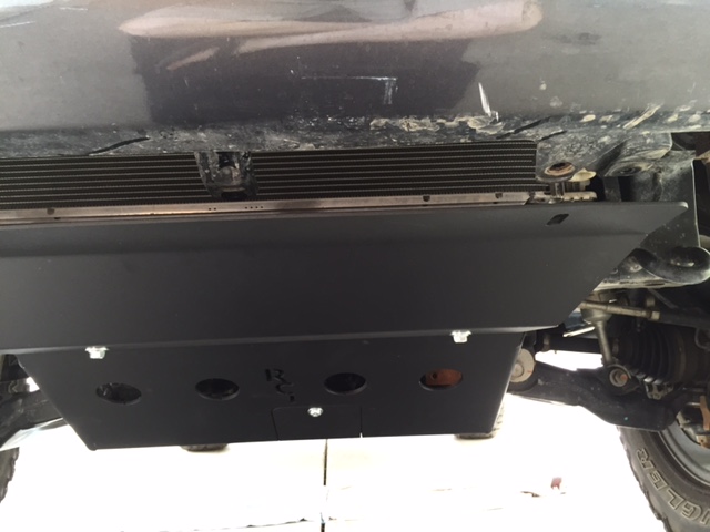

Wouldn't this skid have to be different between Trails and SR5/Limiteds?
[MENTION=86190]Alex T4R[/MENTION] you haven't done the conversion yet have you? Your's look likes it lines up very well in comparison to [MENTION=6163]phillyd2[/MENTION]'s who has done a conversion. I wonder if this wasn't designed for a trail?
I need to get home and see how mine fits.
EDIT: It looks like this is the case. Check out the picture on their site - that's clearly an SR5/Limited Bumper:
http://rcimetalworks.com/10-14-4Runner-Filler-Plate-Stock-Bumper-T4R10-13-05.htm
10+ Toyota 4Runner Filler Plate - Stock Bumper
No i haven't done the conversion yet, but 4Shore(Mike) has trail and his lined up pretty good too as he mention before.

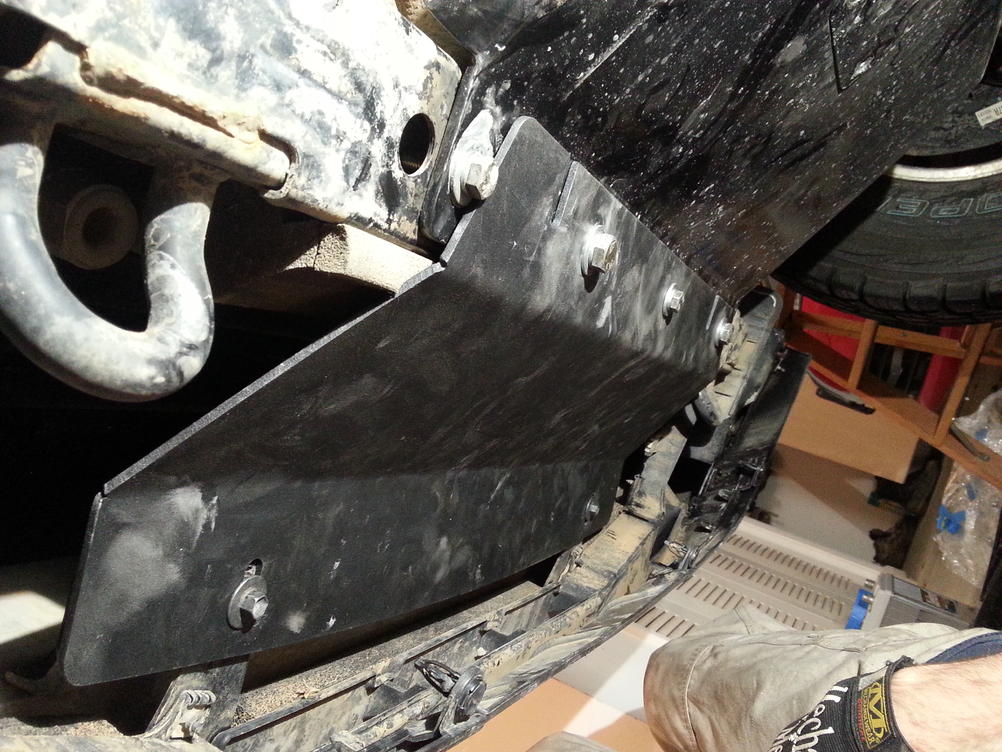

To add onto Jicko starting this question, I got the RCI plates through the recent group buy and I'm wondering if the bumper tabs are about 1.5" higher than the 2010-2013 bumpers? When I slide the bottom of the filler plate between the RCI front skid and the frame, then I have about a 1.5" gap from the top of the filler plate to the bumper tabs. I see that some had to get "longer bolts" but it doesn't look like you've pulled the bumper tabs down enough to compensate for this much of a gap...?
It also seems like the bumper tabs are about 1/4" further apart than the holes on the RCI skid. I might be able to get the bolts in without crossthreading due to being at an angle but until I solve for the gap I can't confirm (and if I try flipping it around, it bumps into a different part of the tab so I can't try it backwards).
