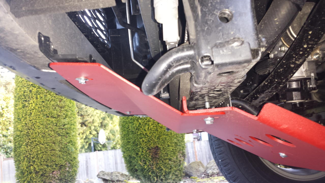

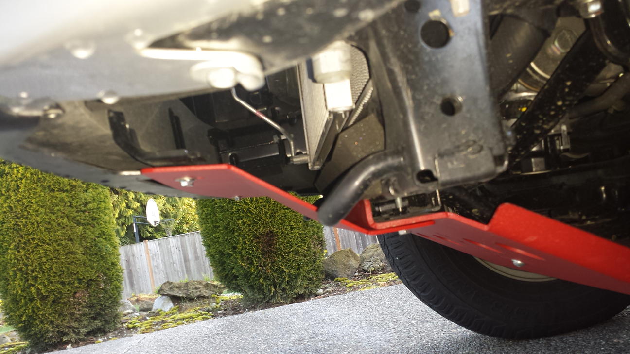

Hey, sorry I thought my photo uploaded with that post. I guess it didn't go through. I attached a pic of it below.
The plate lined up and installed without any problems. I loosened the front skid plate bolts first and slid the filler plate into there. Tightened the bolts to the bumper tabs then proceeded with the skid plate bolts. No bending needed.

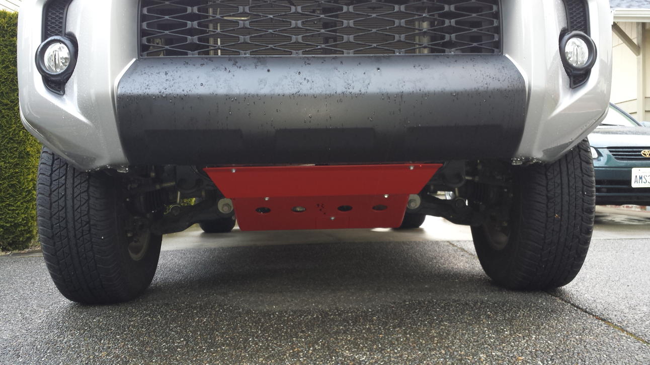

Can you guys post a picture under the "chin" of your truck? Where the OEM plastic piece bolt in?
I am wondering if the TE "chin" piece add any thickness to the picture.

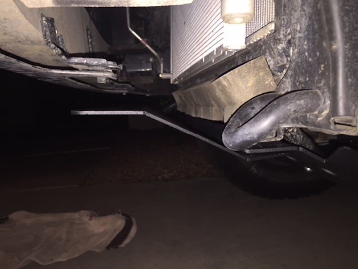

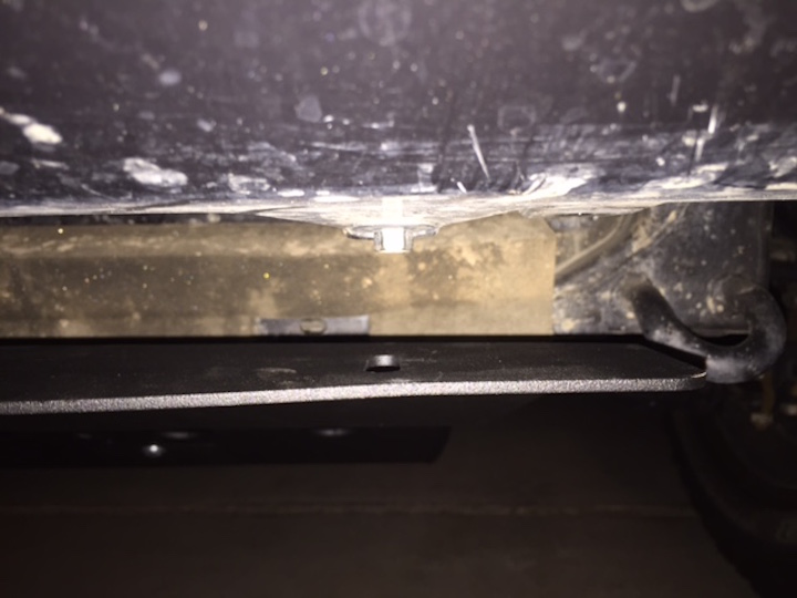

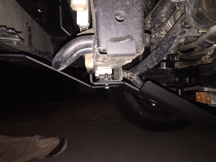

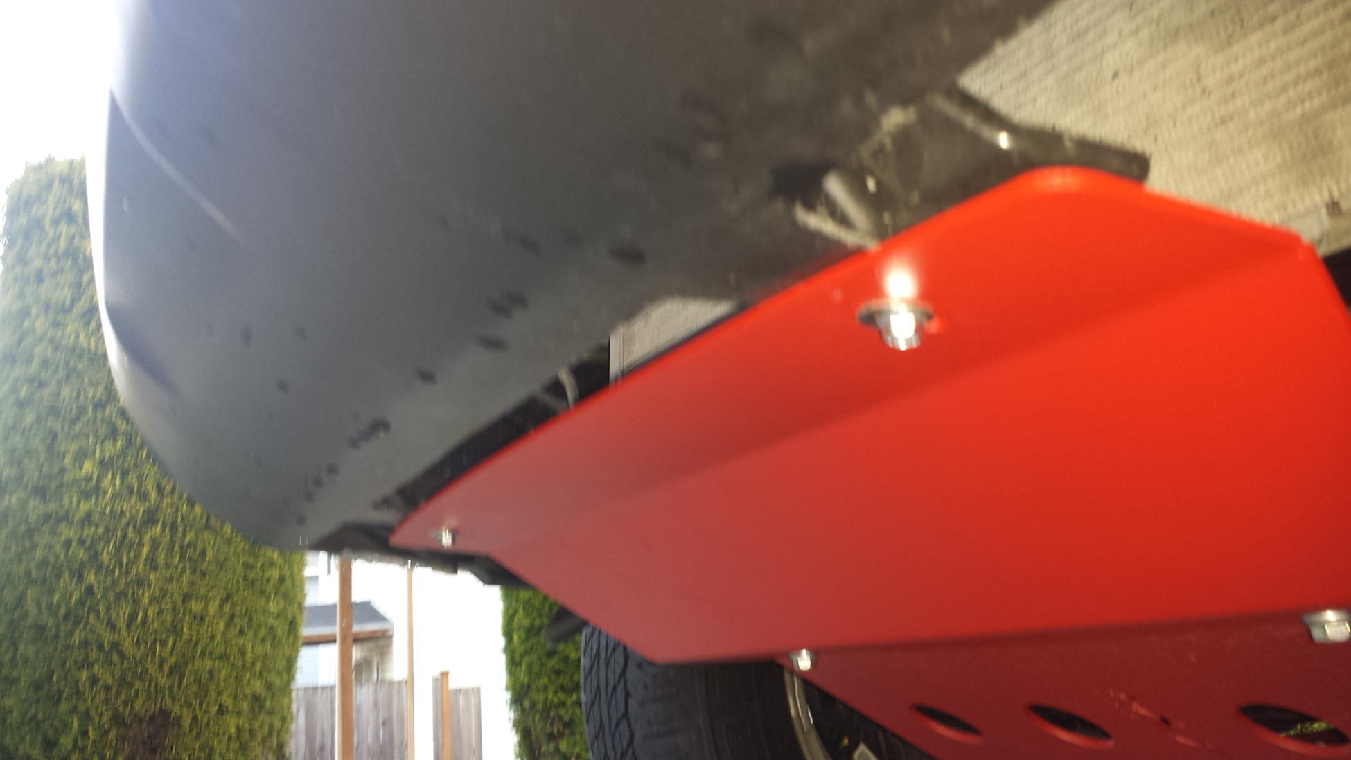

Well that's frustrating, I wonder if I got a filler plate for a different vehicle? You didn't have to remove anything from the front skid plate area right? As you can see, my front skid is bolted on directly to that front rail under the radiator, but when I put the filler plate on there is way too much of a gap.
On top of that, while it's hard to show in a picture you can see that the drilled hole on the filler plate is about 0.25" off from being lined up with the bumper tab bolt. Not sure if the bolt would go in clean or if it would go in at enough of an angle to cross thread even if I could get the plate to line up with the bumper tabs...

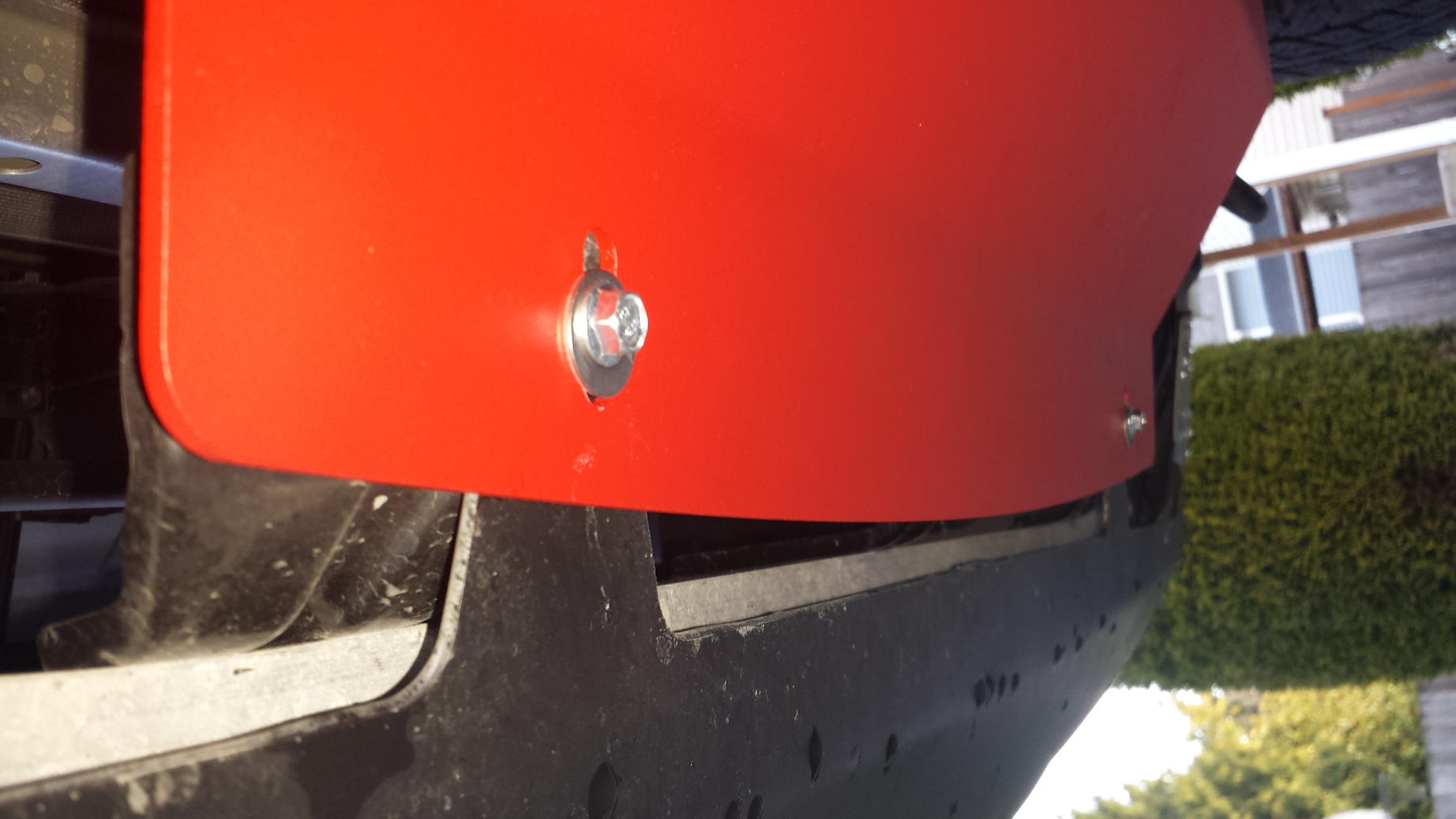

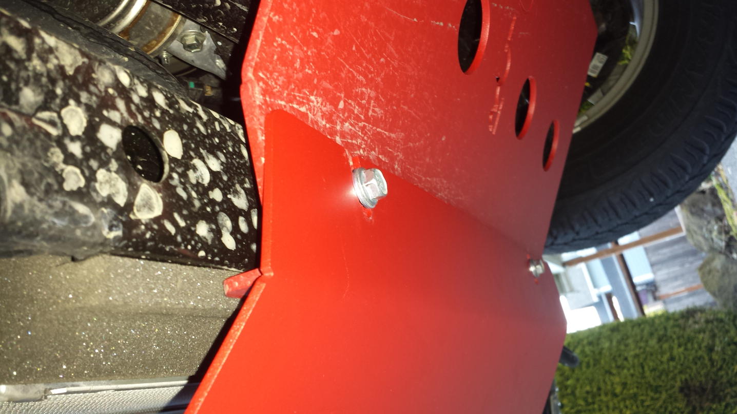

Pics of my plate
Pics of my plate
Thank you - I can't see anything with your frame/mounting/etc. that is different than mine. One last question, if you have time...would you mind measuring from the ground to the bottom bolts (where the filler plate and front plate overlap) and then from the ground to the top bolts (where the filler plate attaches to the bumper tabs)?
