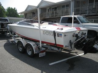

I sold my diesel F250 4x4. It pulled my 5000lb boat like it wasn't there.
Now I'm ready to buy a new 4runner, but before I spend some serious money- will it handle my boat okay? I know there's a 7000lb tow rating, but I want to hold my speed on the highway.

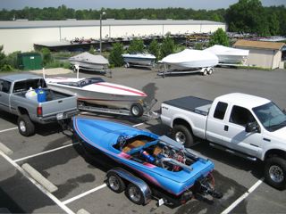

My boat is the white one in the pictures.

I occasionaly tow a 26ft Hacker (Mahoganey (sp?) boat) with my V6 in flat, fast Florida. While our hills are little more than the humps for bridges it does very well. 50-67mph is sometimes is best driven in 4th gear (in my case). Once you get it over that speed anything up to 80 is easy and it stays in 5th with no problems.
The trailer is a double axle with surge disc brakes. The overal profile of the boats is similar.
I think the reason it works so well is that it is not a camp trailer. The aerodynamics of the boat on the trailer is very good compared with that of a camp trailer/closed utility trailer. If you search through the Gallery section you'll see many fairly large camp trailers with happy T4R owners.
In no way will a V8 T4R tow like the diesel but based on the performance of my V6 with a similar load I would speculate the V8 would be very good and when you weren't towing you'd have a super-sweet ride.
:cheers:
I would say you will definitely be able to keep speed.
Considering I towed a 5000 lb boat with the V6 and it didn't feel like much, the V8 will be even better.
