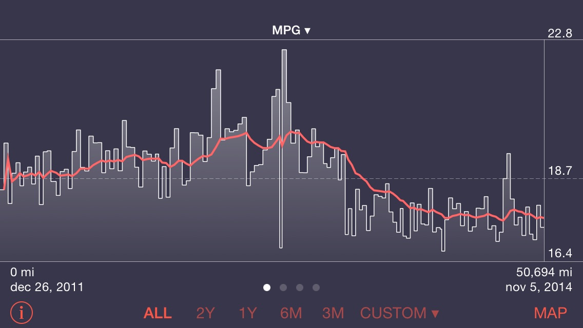

Can you guess when I got my lift and 285's? This is 50k miles worth of data.
