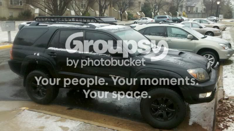

The moral of my long winded post and why I am writing is I just cleared off the snow from my chicks 2008 V8 all wheel drive X5 with pirelli scorpion snow & ice tires. It was sitting all day and we got about 12 inches maybe a bit more because of the drifts. I get in the truck turn on seat warmers, defrosters,and turn of DTC. I put the truck in drive barely giving it any gas whatsoever. To my astonishment this thing doesn't even break a sweat. No annoying clicking noises(like our trucks) nothing just as smooth and confidence inspiring as if there was no snow or ice. I try to get squarely around a turn, smooth as glass. I jam the breaks on and no annoying abs kicking in all crazily. I drive into a huge snow drift and stop and start to think if I was in my truck I would be screwed. Again give it gas and it motors right through. I mean I guess thats what $75,000 of bavarian enginering gets you:lmao:
So in closing I still love my truck and this year I did a few mods so I wouldn't have to sweat 2 or 3 feet of snow or be embarrassed with snow handling. But after driving mine for the last 5 hours(if you live in dc thats the average commute time during this storm today)spent helping countless people with my tow strap and shovel, I wanted to speak my opinion since I felt it was pertinent to the conversation.
ps, what my truck looks like now.
2005toyotapics.jpg~original
