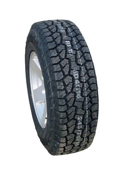

And I got news for you....snow tires don't look like A/T tires or M/T tires. Snow tires aren't designed to clear snow out of them. And there's good reason for that. Snow tires RETAIN snow in their tread by design. Take a hard look at modern snow tires and you'll see that they don't look like the old school snow tires anymore. This isn't 1970.

Also as far as tires, snow tires do look more like a AT tire with softer compounds and a lot more siping vs a conventional highway tire. At the same time they don't look like M/T either which I never said they did.
I've been doing so much offroad driving in deep snow with my 4Runner that it's not even funny. Have you ever heard of the snow in Syracuse NY? It's in the top 3 snowfall areas in all of the U.S.
Here's a Blizzak snow tire and a typical A/T tire. Look nothing alike to me other than they're both round and black.
