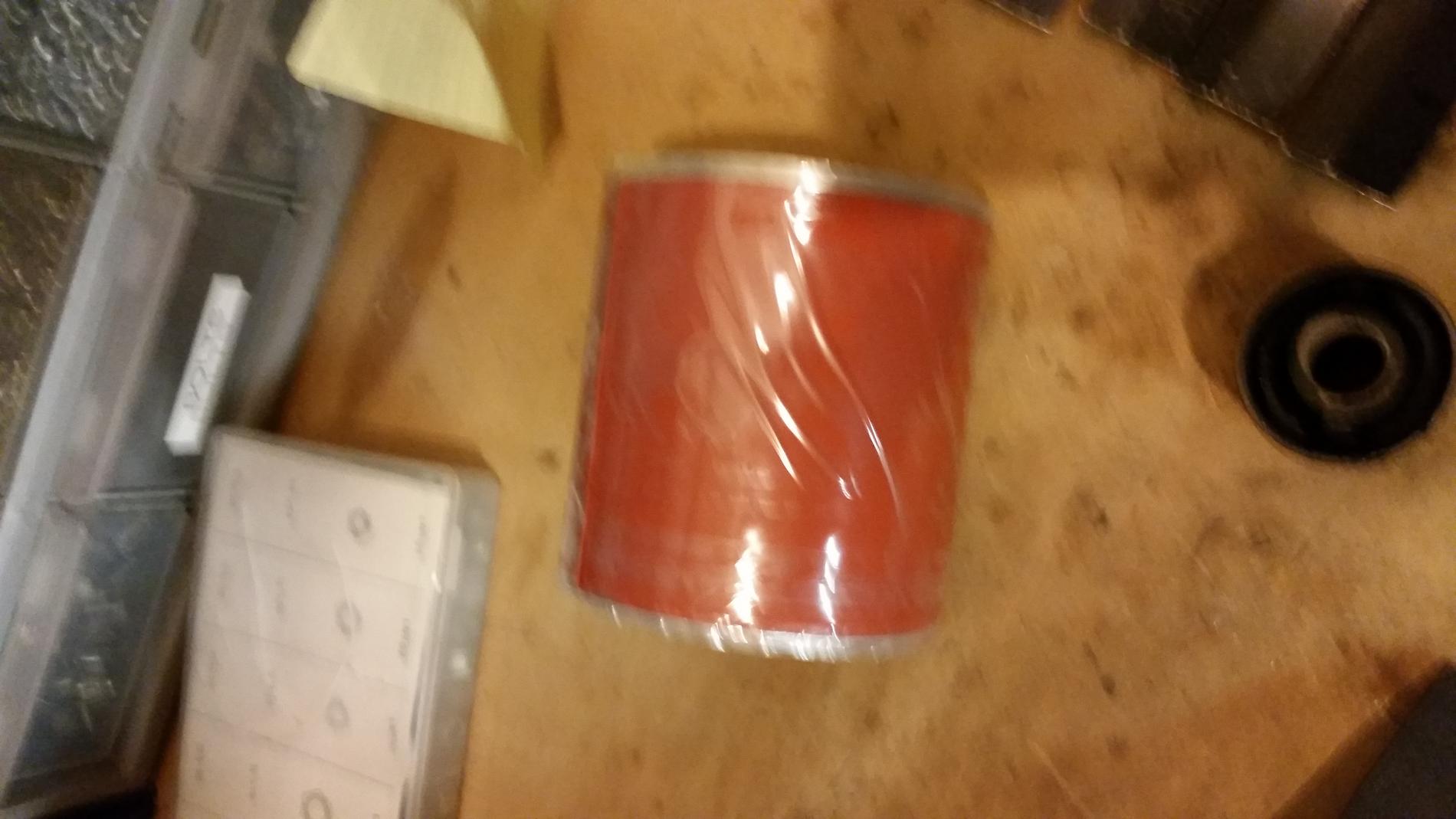

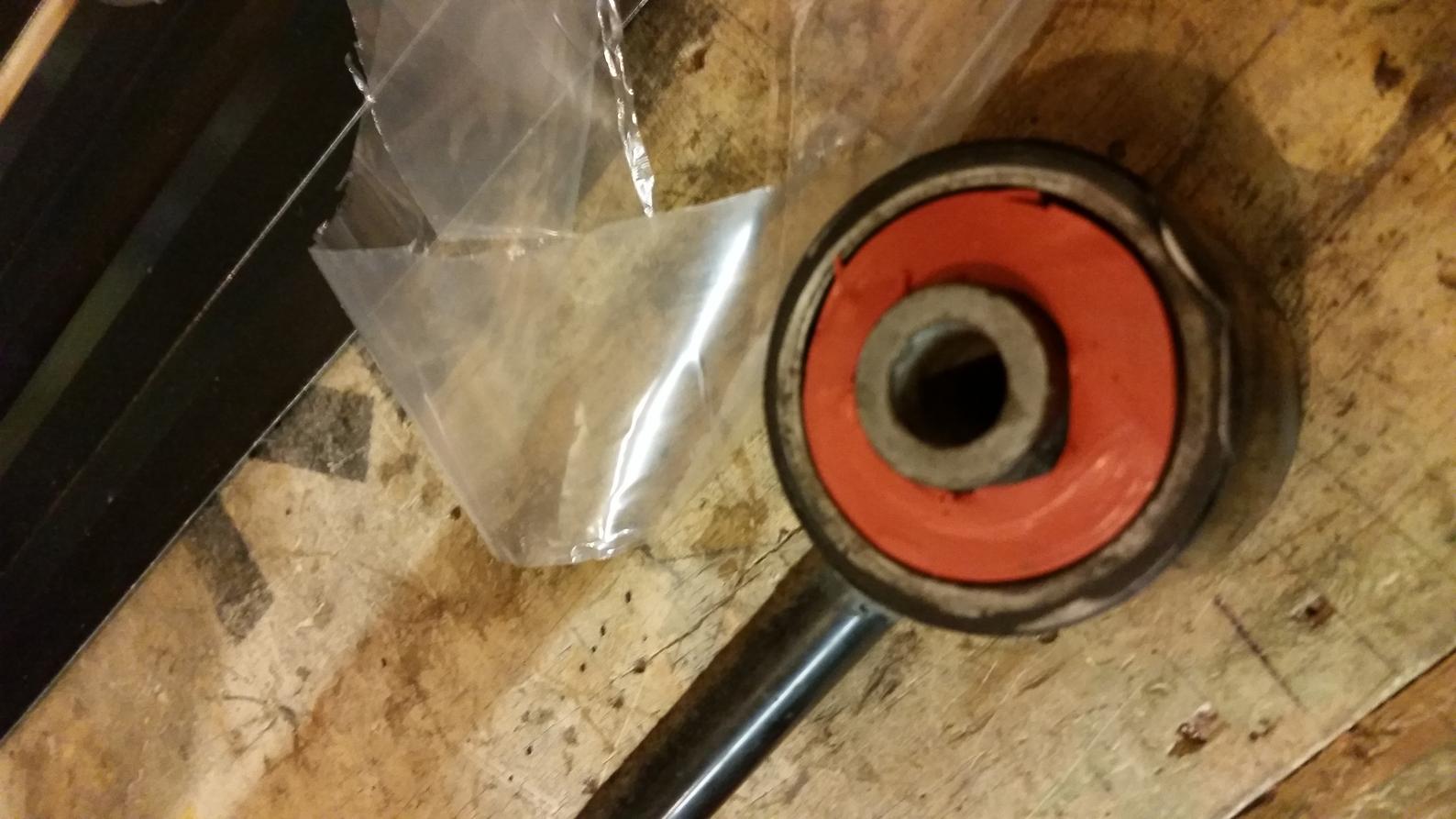

Yeah it moves all over the road, I just got my bushing, it was the wrong one so I'll probably have to order a new upper link, however for now I found this special rubber tape, basically when you stretch the rubber it sticks to itself, the metal tube was still fine so I wrapped the rubber tape tightly around it, then trimmed it with a knife, it was actually just as firm as the stock bushing and it fit perfectly, it should hold for a few days till I can get the new upper link. the clank is gone now and it handles way better no slopping around.
