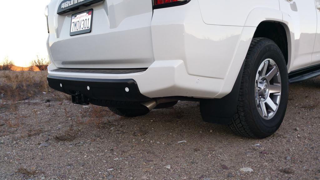

Wow forgot all about this post. They work great but can give false positives on some road surfaces.
Take your time measuring and use the included hole saw.

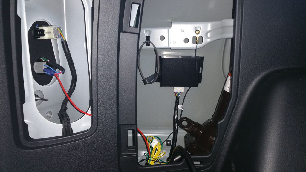

I tapped into the backup light for the backup sensors. I didn't use the turn signal lights. CPU is mounted behind the tool kit.

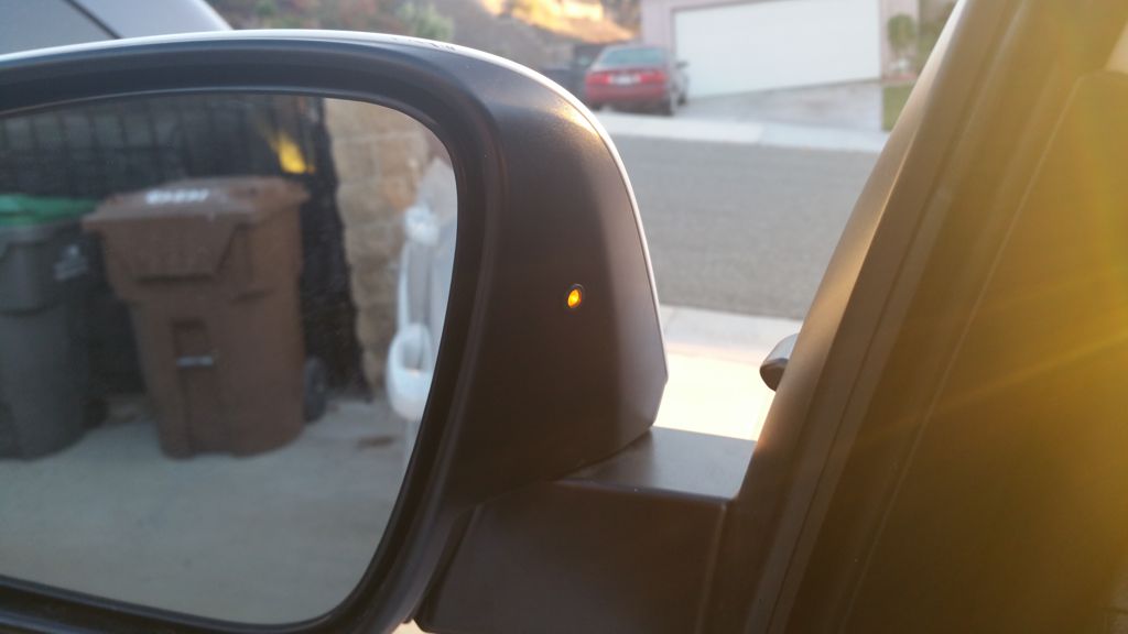

It had cheesy signal lights. I removed them after a few days.
I replaced them with LEDs I put in the mirrors.

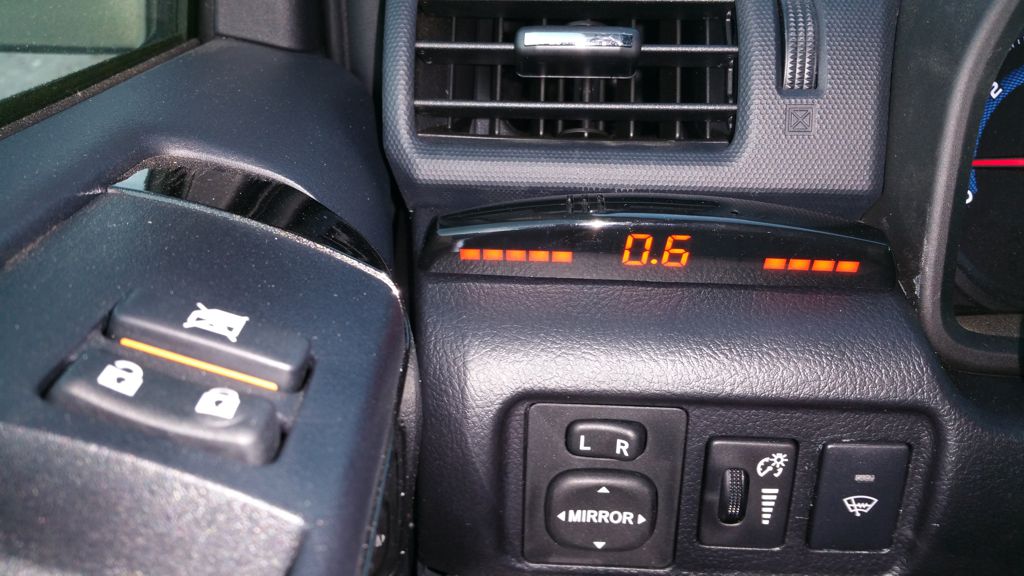

The display fit just right on the dash.
The sensors look like factory ones.
