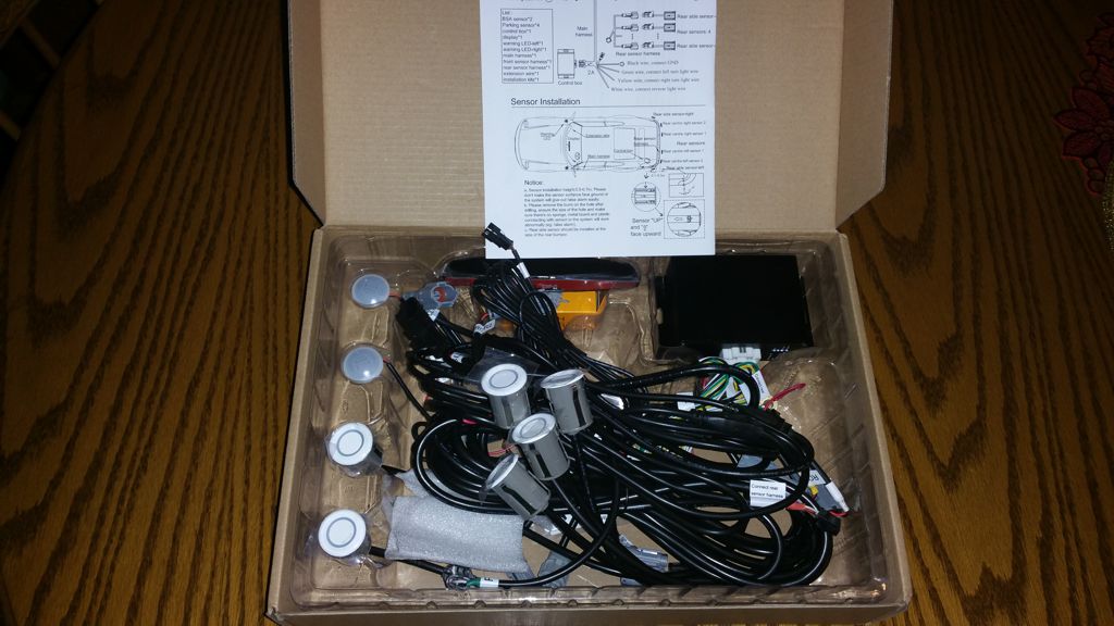

OK it arrived faster than I expected. Now I just have to install it. The kit looks to be well made at least.
Looks good. So many to choose from, do you have a link for that seller? Thanks.
HOT BSA rear car blind spot assist system rear parking asssit and side collison warning system F0651 parking sensor-in Parking Sensors from Automobiles & Motorcycles on Aliexpress.com | Alibaba Group
They have different sets if you want the front sensors. I didn't order them. Make sure you look closely at the details with the amount of sensors and what is included. Don't rely on the pictures. The set I ordered was $154 with free shipping. When you receive it have fun reading the installation instructions with all the warnings. The translations are a hoot.

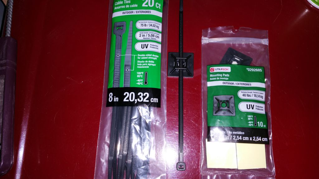

No matter what kit you go with make sure to pick up some zip ties with mounting pads. I started installing it today and there's not really any good place to tie up the wiring harness in the bumper. With these you can tie them and stick them to the inside of the bumper.
