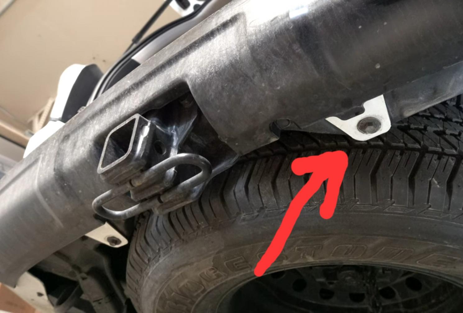

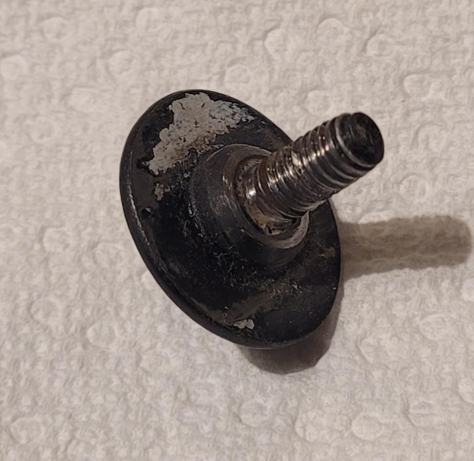

I removed my rear bumper today so that I could remove the lower valance & paint it black. Unfortunately, the head of one of the two 10mm bolts holding the bumper on from underneath snapped off. Fortunately, it was pretty easy to repair (drill & tap, 6mmx1.00).
Does anyone know how to find the part number for this bolt? It has a shoulder washer integrated with the bolt head, so it's not a "regular" bolt.

All mounting hardware are shown on the parts diagrams at the OEM parts web site: parts.toyota .com Just search for the panel you want the bolt for.
No reason you can't use a high quality bolt from a local industrial connector supply company. Just don't get the ones from a hardware store for they are junk.
For anyone that may stumble across this...
The bolt pictured is Toyota P/N 90109-06330.
Five of these bolts (along with one plastic push pin) are also used to attach the plastic trim piece between the factory skidplate & front bumper.
