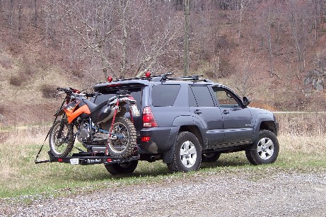

Here is the rack I use to haul the LC4. The Versa Hauler. How are the air bags working out. I could have used them when I went to the Mt.'s this summer. 4 adults, gear and the KTM!

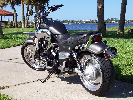

I don't think my other bike would fit on the Hauler. 01 Vmax - not a chance. I think I have the one for 300lb and under. Perfect for the dirt bike but not the street fighter. I was thinkin of getting a 2 bike pull behind - but not the fancy Harley enclosed one's.

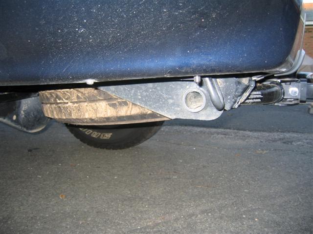

I put the schrader valve thru a body attachment hole that wasn't being used on the rear bumper on the driver's side. It's a few inches from the rear tow loop.

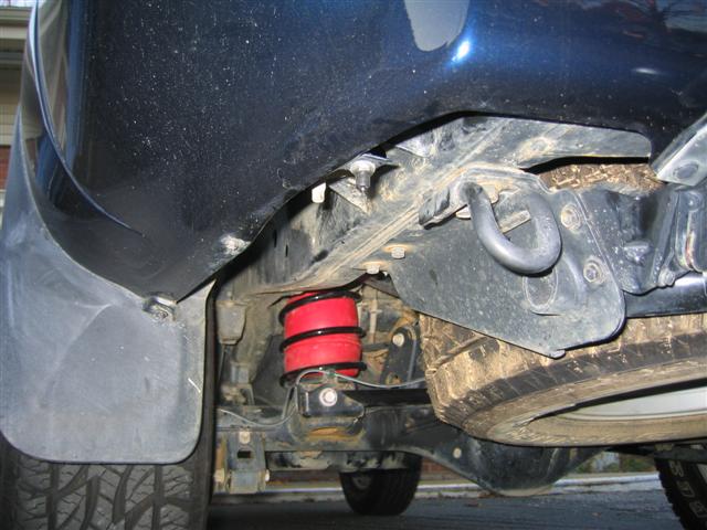

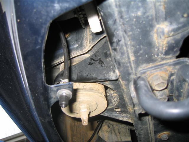

Here's the pics I promised.
This is the left airbag. You can see where I put the valve and my cut bumpstops.

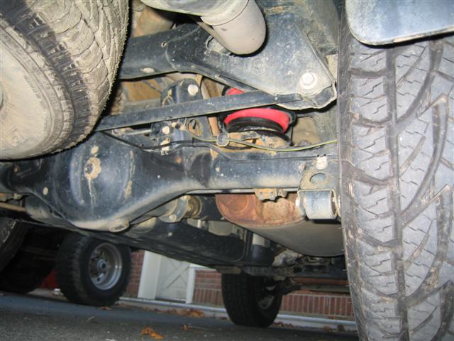

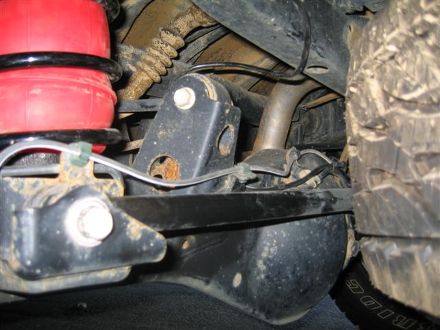

Here's a shot of the air lines kinda. From the left side.
