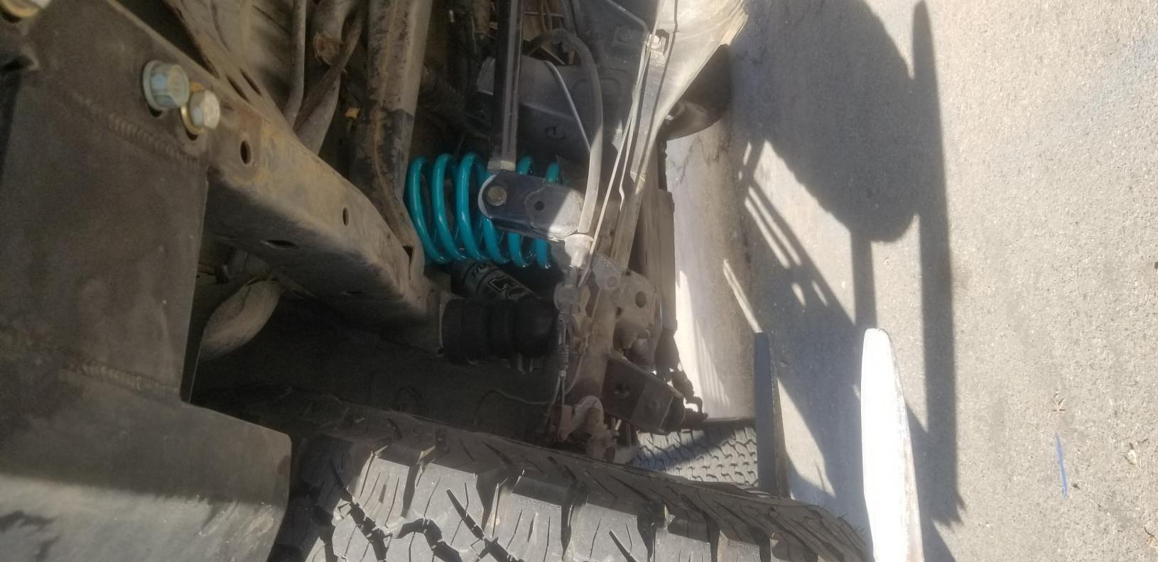

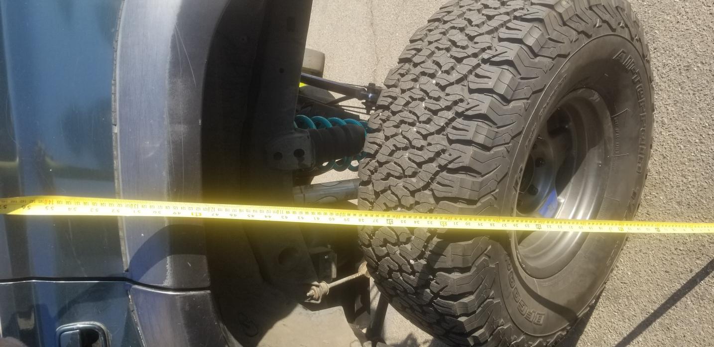

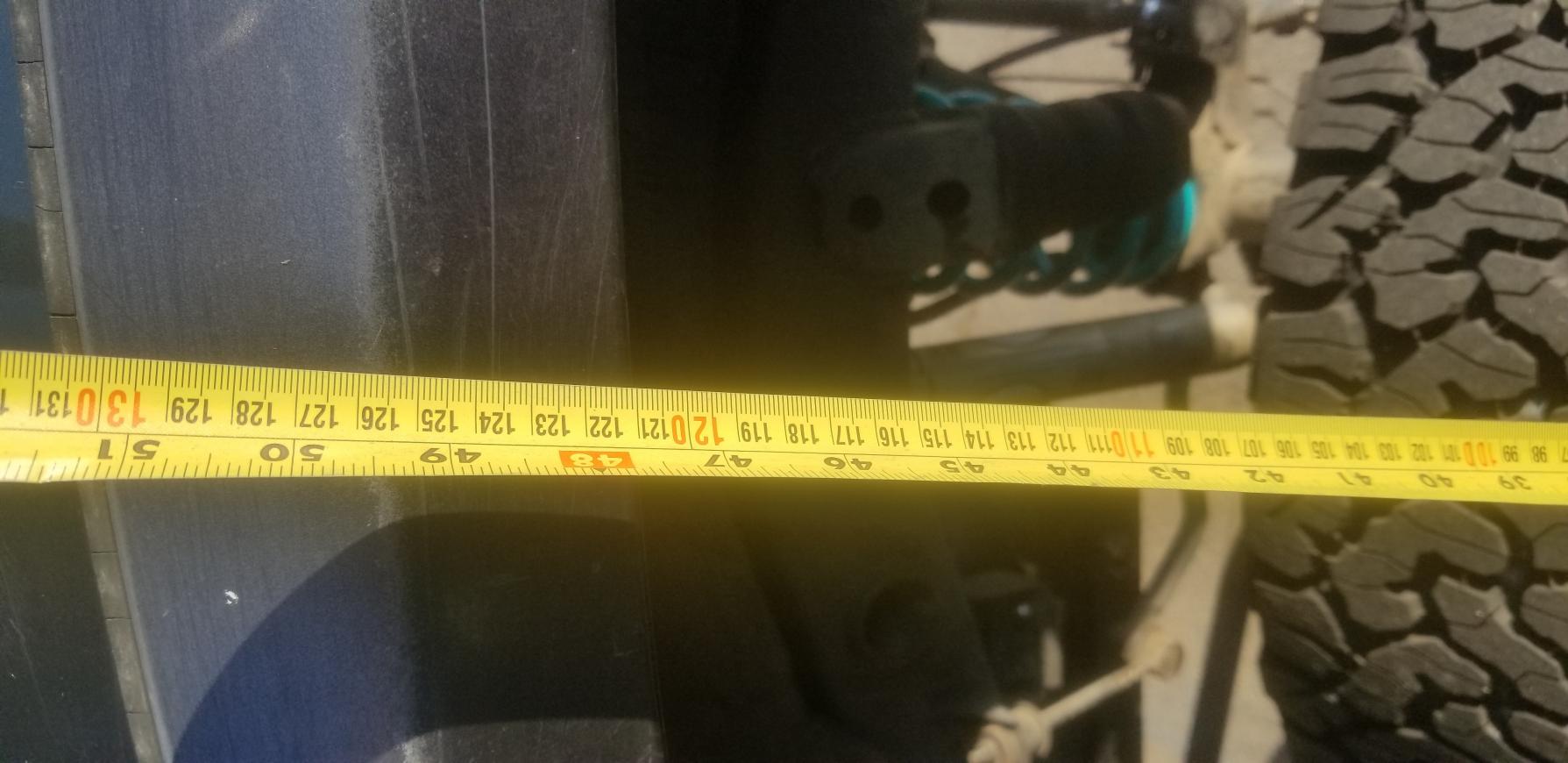

Just installed the new 210v, over all very happy compared to the LC7.5. also installed a set of durobump 5.25 bumps. Sorry guys not sure why I cant rotate it around.

Very curious to hear the differences from you because it looks like we might have a similar weight situation out back sans auxiliary tank but you may have more in the cargo than I do.

The ride is a lot more plush, a course my shocks aren't anything like yours. I'm on 210v paired with Foxs 2.0 from a Tundra. No more bottoming out compared to before a bit tighter on corners but overall the weight is what I wanted most. Which the 210v seem to do very well as for now. We will see it how it does after I abuse it on the Trails here in Fresno!
