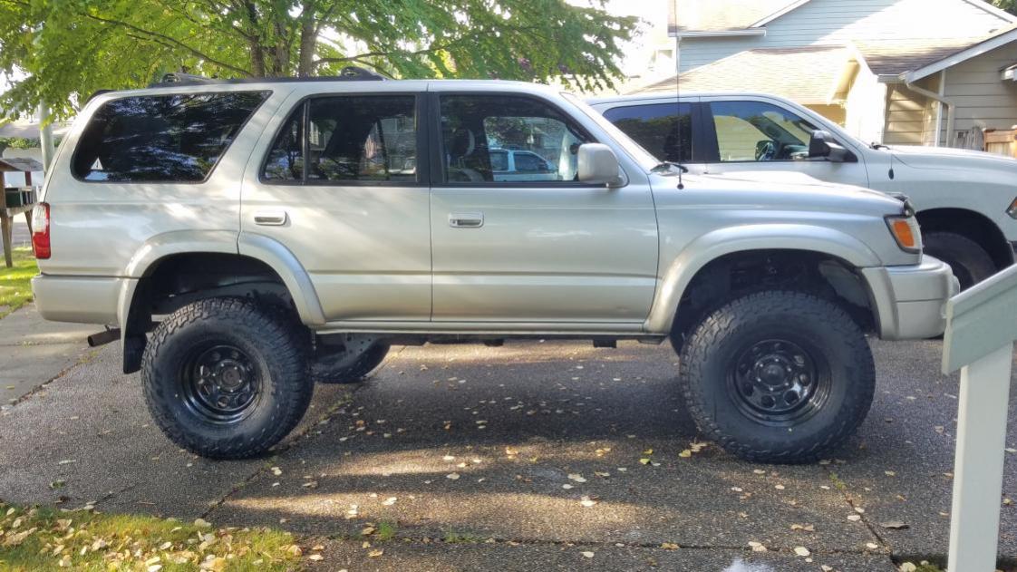

Just installed my rear half of the lift today, with my 210v and Tokicos. Man, is it a lot of lift without any weight. Definitely gonna have to pick up some sandbags until I snag a rear bumper. Kinda wishing I went with the 675v coils, but I vaguely remember something putting me off about them. Didn't fit, maybe? Too lazy to look it up lol

TRD/Tundra 5100 + 210v/Tokico Blacks
Might forego the sandbags, kinda like how she sits as is!
I put the taller 210v on the drinkers side since I had typical toyota lean, but someone my passenger rear is now slightly taller? By slightly I mean just under 1/8in, but still odd

Elevation Sensation!
Indeed so! Loads of clearance now. The rear's a little high for my taste, but I loaded it up with 200lbs of concrete to simulate a bumper and it sat perfect, so I'm pretty excited to grab one. The rake isn't horrible either, can't see it from my driveway but I got about an inch or so? Just enough to give it an aggressive stance without being ridiculous. Of course, can expect some settling
All in all, very happy. I take the backroads all the way to work, and while I beat traffic by a mile they used to be hell to drive on at times - now I eat up all the bends, bumps and cracks it throws at me :biggrin2:
