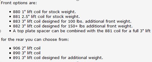

906, 890, and 891 give different amounts of lift. Don't know where you got that idea from but it's inaccurate.
I get that right here from ARB themselves.
Most people get 2" from 906 and 3-3.5" from 890/891 depending on how much weight they have. It also depends on what year 4Runner and how much the current springs have sagged. 99's will gain less height than a 2002 would.
OME will also tell you the 891s can comfortably handle over 200lbs of extra gear, but anybody using them with an plate bumper will gladly say otherwise.
Also this is probably the first time I've seen anybody say the 881s are for additional weight. Everybody that offers them will advise they're for stock weight. That'd be the 883s instead, which they didn't even bother listing, to boot. Not to mention 890s are taller than 891s, both of which offer more than 2in.
The problem with that chart is it's trying to include ALL the 3rd gens, and they weren't all made equal. For example, Highlanders were 1in taller than every other 3rd gen offered.

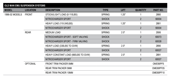

Interesting read Absalom has. I always assumed the Old Man Emu coil springs were the best options for the 3rd gen 4runners. But he doesn't even mention them once.
He mentioned them in the Jack of All Trades build (OME 906 in the rear). A lot of people use 880s or 881s in the front, if they want more lift than 99 talls.
