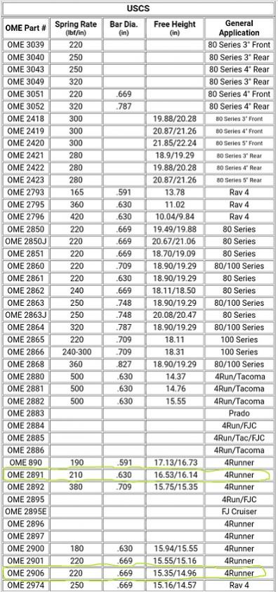

I've often read that 891 were stiff unloaded but based on cruiser outfitters spec sheet, 891 has a lower spring rate 210# compared to 906 which has a spring rate of 220#. The bar diameter of 891 is also thinner at .630" compared to 906 which is .669". On paper, I would think that 891 would be slightly softer than 906.
If you're going to frequently carry +200lbs, I don't think 890 would be a good option.
