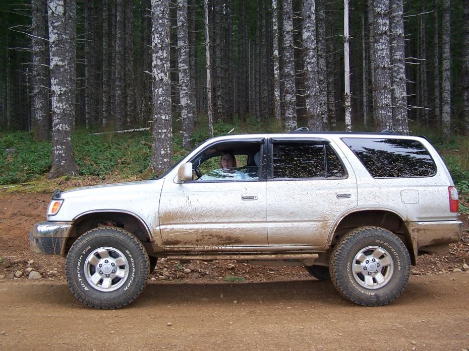

My favorite rear combo was the Downey Off-Road 3" linear rate springs with OME 60027 shocks. I also ran the stock upper isolator with the cones removed and an OME 10mm trim packer per side. That combo rode super nice on road, dealt with the loads I subjected it to, including towing, and absorbed off-road bumps nicely. I was super-bummed when Downey shut its doors in 2009.
I'm reasonably happy with the LC 7.5/Black Tokico combo I currently have. But it annoys me that I need to keep weight in the back to have it ride at the height I want and with the ride quality I am looking for as well. If I could figure out a way to cut a wrap off the LC coils, I'd do it.
I've included a picture from 2004 with the aforementioned Downey/OME combo in the rear with SAW's in the front set to ~2" of lift. Stock wheels, 285/75/16 BFG ATs. My wife is mugging for the camera. ;)

Man, the glory days! Reading you talk about Downey Offroad and your photo with the OG BGF K0’s made me take a trip down memory lane.
Looks like a nice setup! And I totally agree - LC 7 wraps are great but you need some weight to sag em so your not rolling around on 4”+ of lift.
The SAW's required a rebuild at one point. I had already replaced the lower Heim joints once. Rather than spend more money on the SAW's, I bought the TRD/5100 setup. Huge improvement in on and off-road ride quality. It also flexed better in the front with the sway bar attached than the SAW setup did without. That's why I stopped disconnecting my end links. For the stuff I run, it's not necessary. I have enough dents in the truck, thank you very much.
Prior to the SAW's and Downey springs, I had NWOR progressive springs front and rear with Bilstein 4600's. The NWOR springs either sagged (front) or rusted out (rear). They also rode pretty terribly in the rear without a load. I ran the Downey's with the 4600's for a while. The OME 60027's were another big improvement in ride quality. Those shocks ride pretty good with linear rate springs and pretty crappy with progressive springs in my experience.
