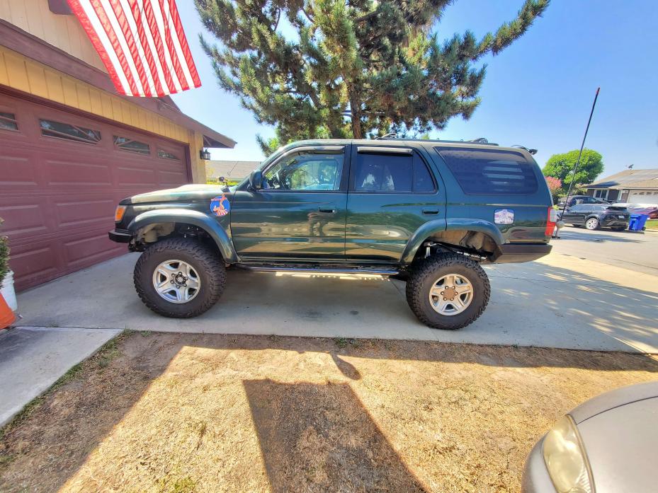

Well I just put in my 210v's after outboarding the rear shocks (had 891's before). Jesus, it's like a 5"+ rake! FFS! I have a eimkeiths bumper, spare inside and a full f150 fuel tank and it still sits that high. Though I'll be adding a swingout shortly, 3 gas cans, water and a drawer and sleeping platform soon too. But I still don't think it will drop the height that much.
So I don't quite know what spring to run yet again. Either a 891 again (it saged about 2 inches or more), the lc 7.5 wrap 48131-6A570, maybe a 906 or 890?man I wish there were more springs to choose from.
Lotsa folks recommend and run the OME 861s with setups like yours. Landcruiser springs.
Hope this helps.
Thanks guys, I'll give the ome 861's a try and see what happens.
The good thing now as it sits I can check the oil level in my driveway LOL

Now THATis one sexy rig!!!! Sheesh!! Someone call the fire department!!!!!
